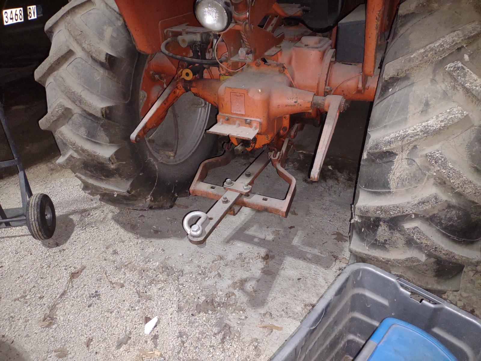

D17 Series III.  Snap coupler ends are gone.  What's the best option/source for a three point system, so I can run modern implements?  I'll need to keep/have PTO function still.

this is simple.. takes the place of your drawbar... you need to add a TOP LINK / anchor.

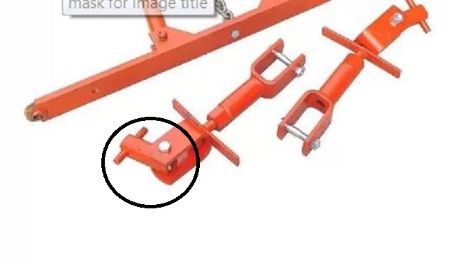

Buy a pair of used lift latches and the adapter from OK Tractor that bolts to the drawbar.  Job done.

If you take off the lift latch adaptor, it appears the hitch would pin directly to the lift arm.... dont know if it has enough "side swivel" or enough movement ???

I went with OK's, and their upper link mount.  They have good pics, showing it bolted to my bare lift arms, and it uses/clears the draw bar for side to side sway.

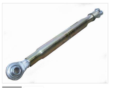

I dont think you need that "SCREW"... you need just a top link that looks like this... normally $30-40. . You can buy on line or at Farm Store... they come various lengths and each is adjustable over a range of several inches....
I would just get the 3 point installed, connect your disc or blade and then measure which length would be best to keep things LEVEL.

The top link bracket bolt's under the seat and then goes down and bolts under the pto shield. You can buy them. I made my own.

As Steve mentioned, you can remove those T bars at the top and I usually use the same bolt through the arms.  Some have put hardened pins in.
