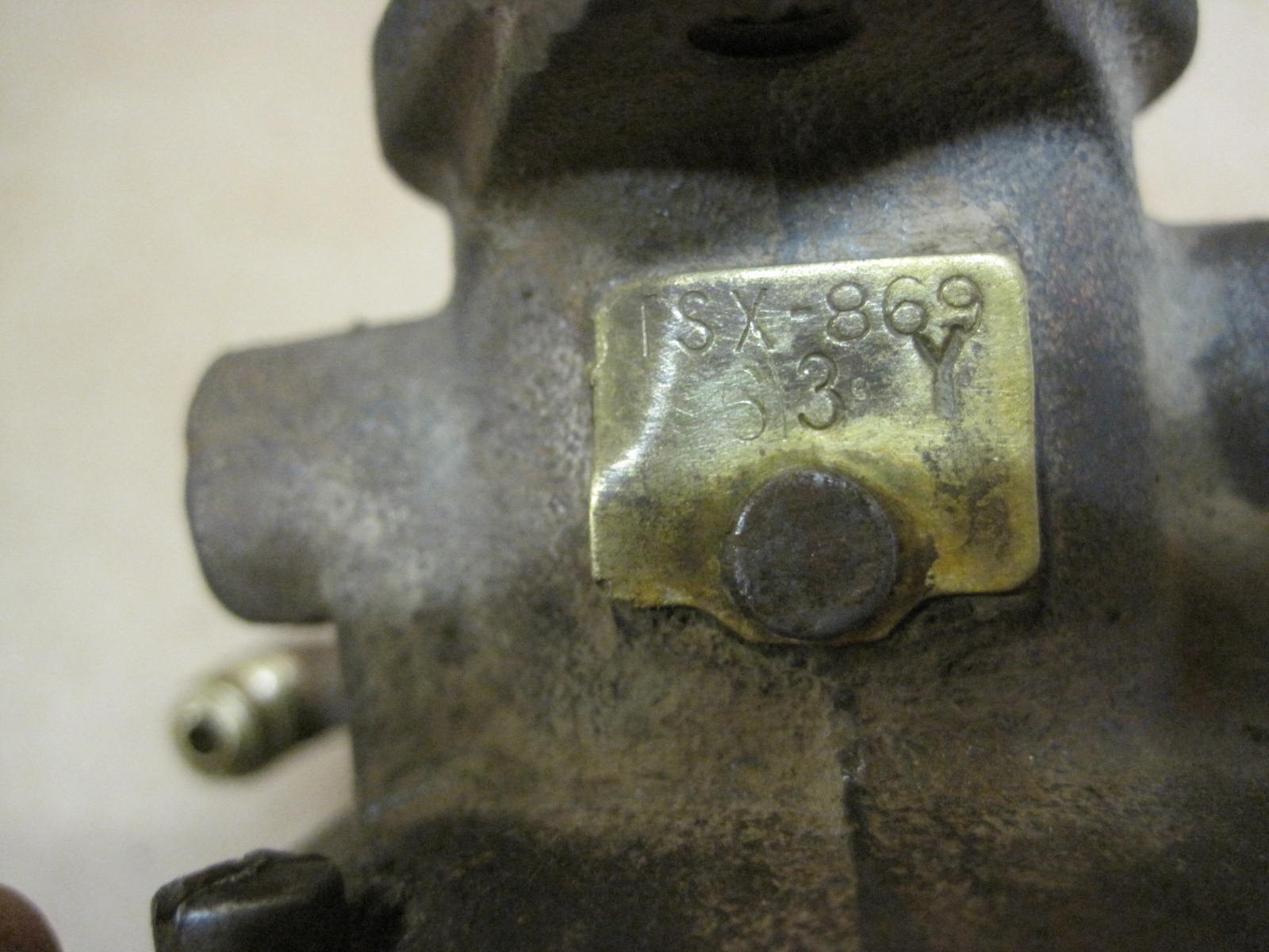

Post Options Post Options   Thanks (0) Thanks(0)   Quote modirt Quote  Post ReplyReply Direct Link To This Post Posted: 01 Apr 2021 at 7:59am
Carb as found on D15 II I'm currently stewarding......
