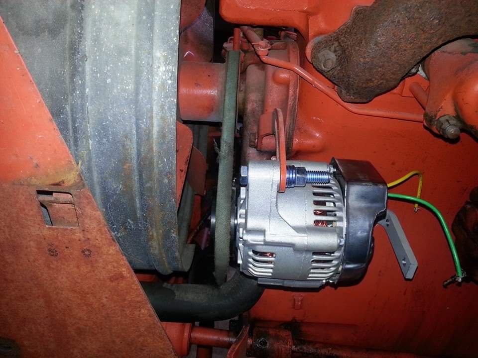

I cobble welded our D-17 series 4 bracket when we went the alternator conversion a few years ago.

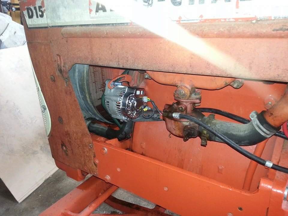

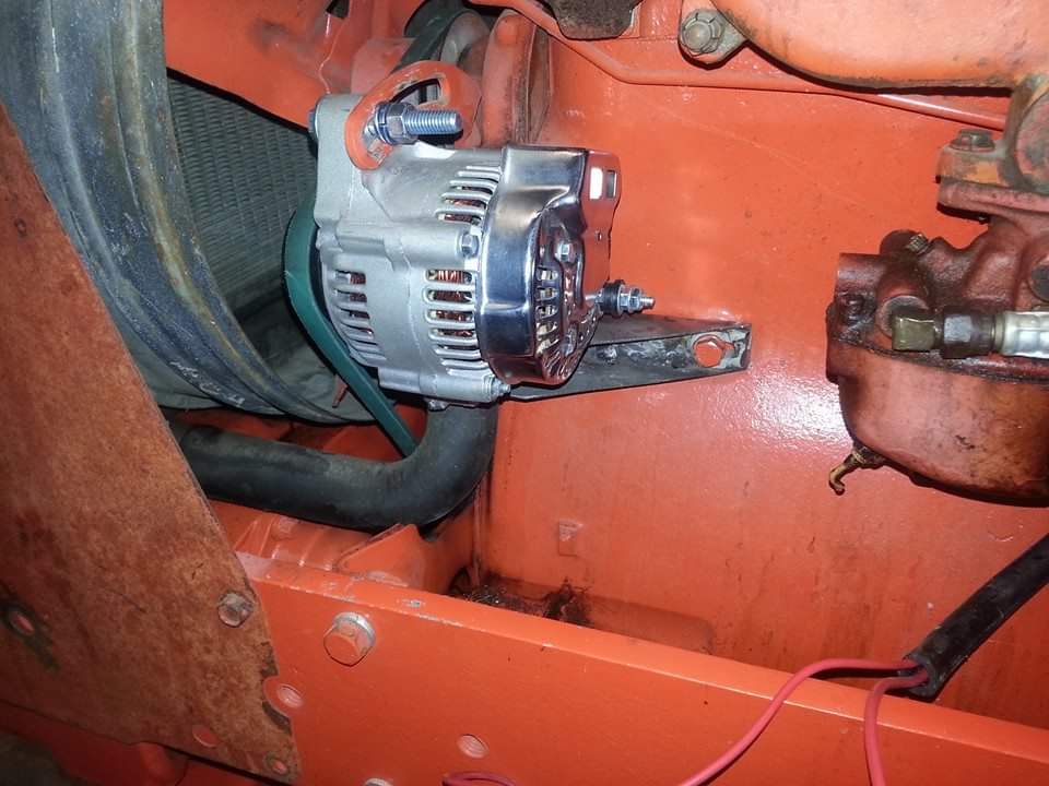

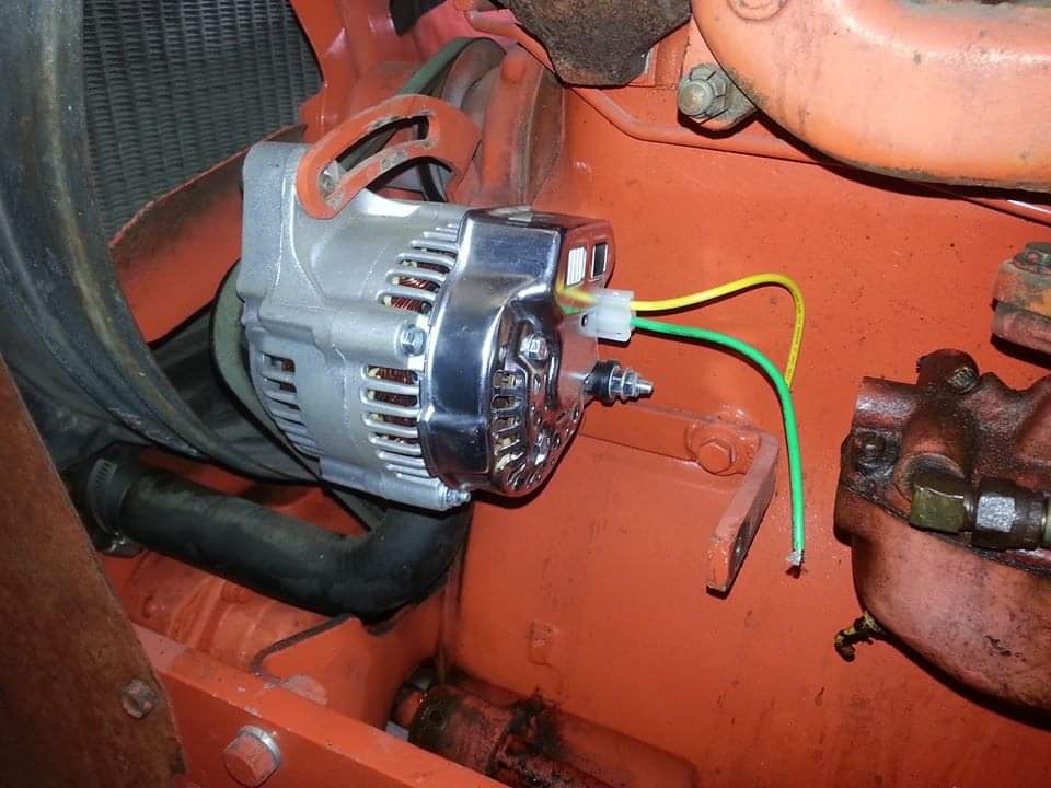

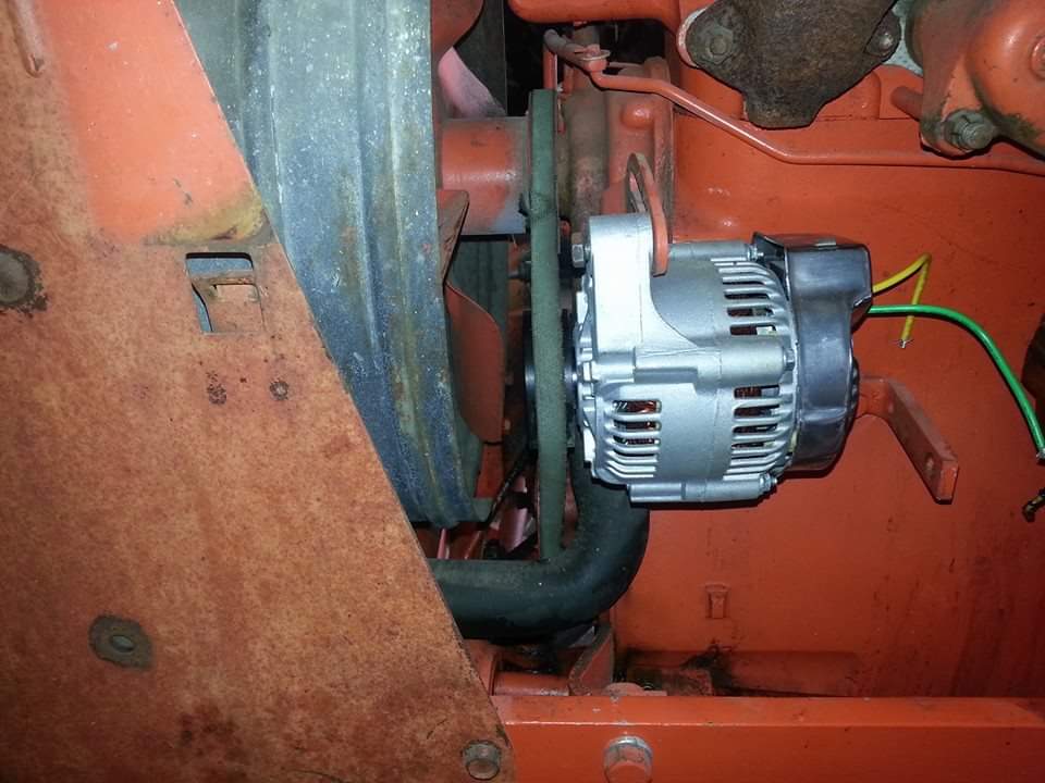

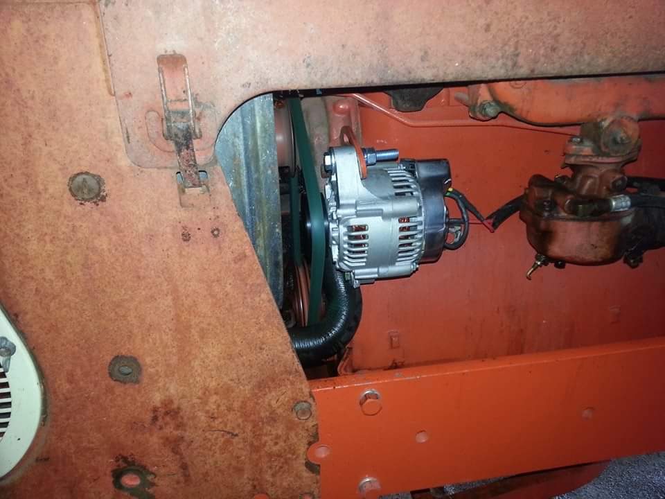

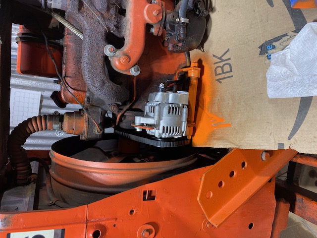

Like doc says, with the mini I took my original generator bracket and cut/welded it to hold the alternator.

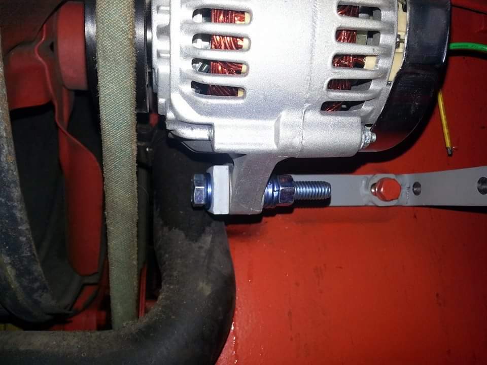

Be sure to use a 1/2" width belt, which is wider than original. The OEM belt is like a rubber band and just doesn't last long or stay tight because it slips all the time on the fan pulley. The 1/2' belt sits high in the pulley but works into place nicely WITHOUT slipping and needing adjustment all the time.

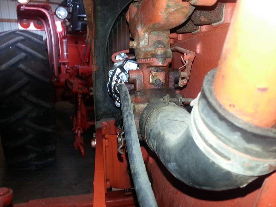

The mini-alternator helped with the installation of the belt driven new "live" hydraulic pump.
