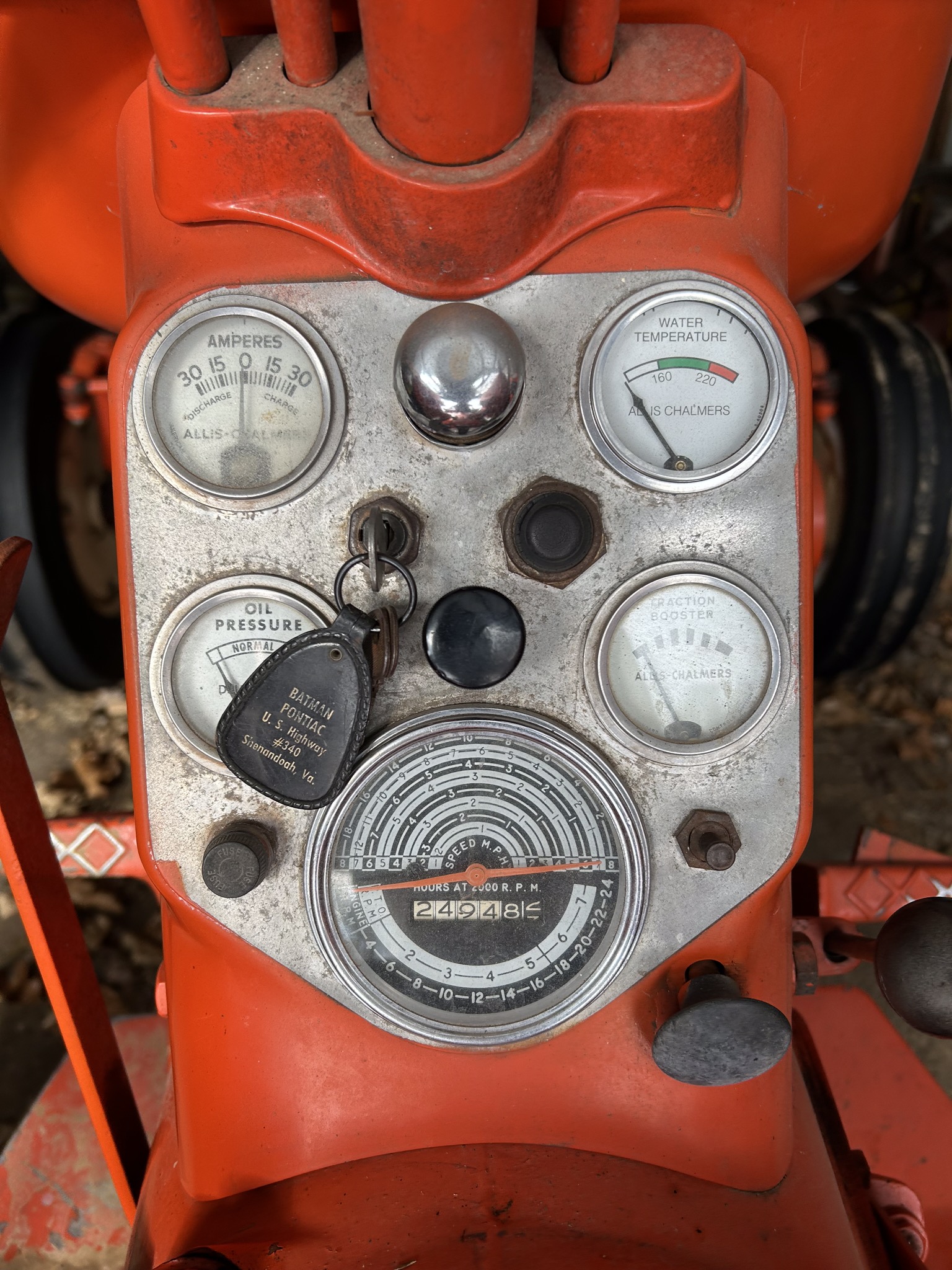

That looks just like my 1964 Series II. The rubber deteriorated and then fell off. Now the start button failed. I can’t seem to find a new one anywhere. Ideas?
D-15 18466
John Deere 1025R
Points: 22772
Post Options Post Options   Thanks (0) Thanks(0)   Quote DrAllis Quote  Post ReplyReply Direct Link To This Post Posted: 18 Mar 2025 at 11:54am
