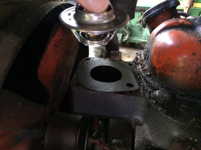

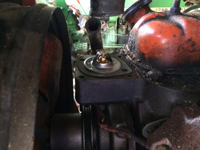

To make sure I understand. There is a gasket that sits on top of the engine block where the hole is for the thermostat housing cover. The thermostat sits on top of the gasket. And because the gasket is smaller than the hole in the engine block, the gasket keeps the thermostat from falling in the hole in the engine block. Then, the thermostat housing covers all of that?
I am confused because if I do that, it would appear that the thermostat is lower on the system than both the bypass hose and the upper radiator hose. That would mean that when the thermostat opens, hot coolant would flow into both the bypass hose and the upper radiator hose. Seems like I'm missing something.

Is it true the thermostat's flange diameter is smaller than the hole in the cylinder head?
The picture in the parts books is nice, but you can't tell sizes, what slips over what.
And since we know it has been buggered with (no thermostat) the poster has a right to be concerned. What if they sent him the wrong thermostat, what if the cover gasket
is wrong or homemade.
I think the function of the bypass hose is to bypass the thermostat with some coolant.
If we called it the thermostat bypass hose I don't think you would now be worried on that point.

I am trying to remember when I changed the thermostat on my D15 years ago, it definitely was smaller and I did assemble it according to the parts book.  I just cannot remember the sequence that I did it in.  The small size did scare me in the beginning too!

This is what I received. Does this look right to everyone. I believe the gasket is wrong since it has two bolt holes and my thermostat cover using four bolts. But is this how the thermostat generally sits?
By the way, without the gasket, the thermostat falls into the hole on the engine block. So the gasket itself is supporting the thermostat.

Yep, just get the proper gasket.  I think the top part of the stat housing has an indentation for the thermostat to get centered in.
