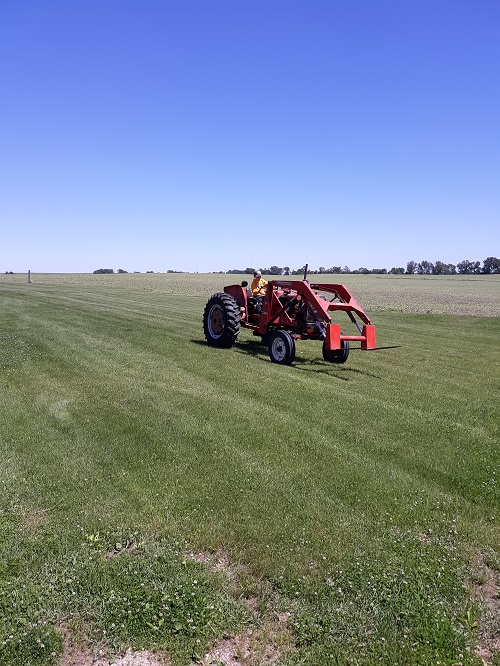

Post Options Post Options   Thanks (0) Thanks(0)   Quote Kenny L. Quote  Post ReplyReply Direct Link To This Post Posted: 14 Mar 2021 at 11:01am

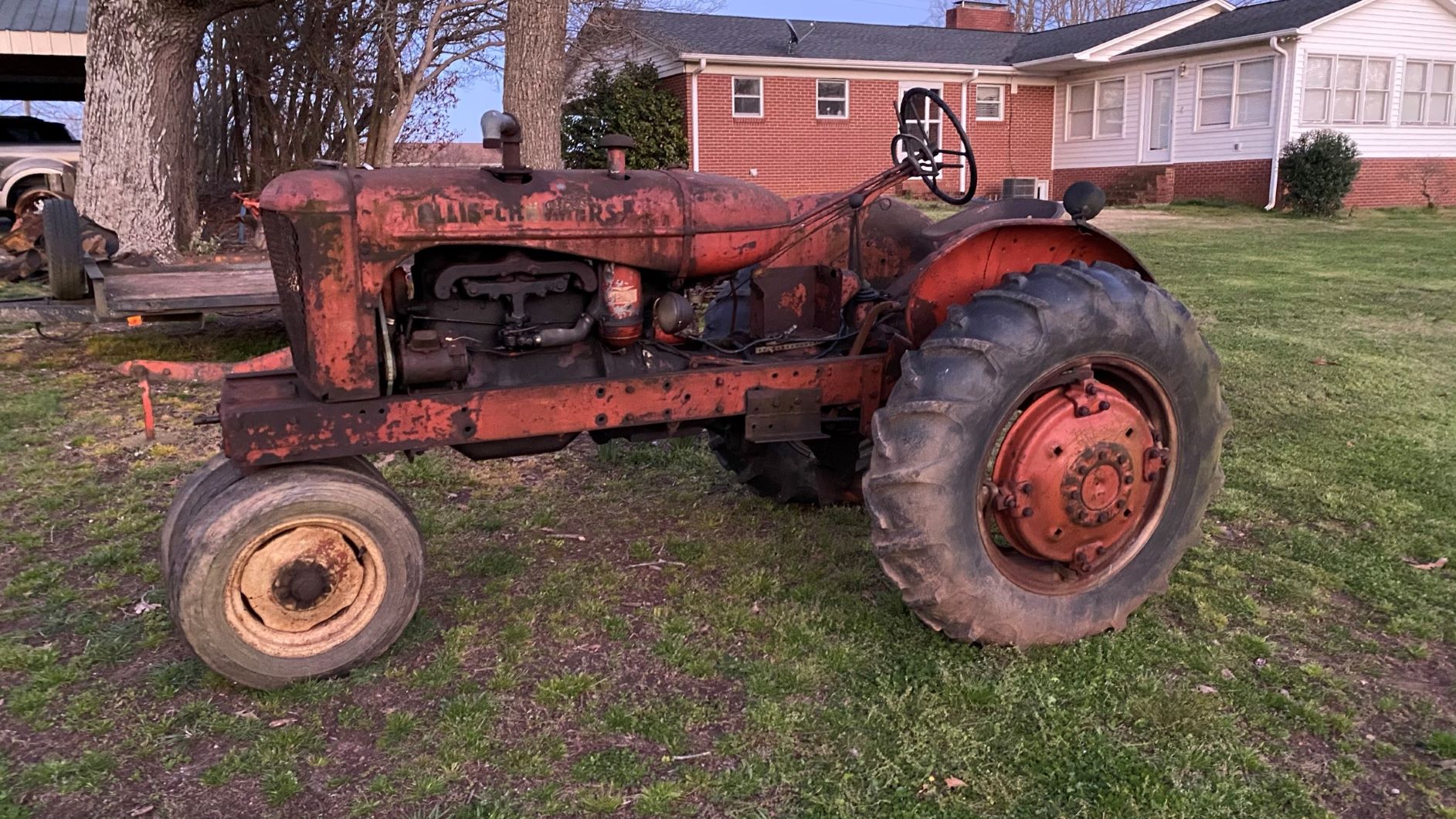

Here is a picture of my D-15 with 13.6x28 tires and 12x28 rims and centers from a WD

Yes, My D15 I,  has had 13.6x28" on it for 30+ years. They came off donor WD45. Be warned, it really increases speed over the stock tire size, whatever that was.

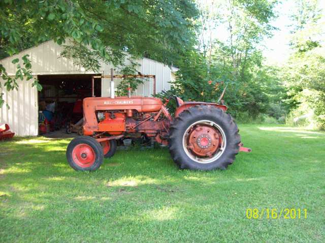

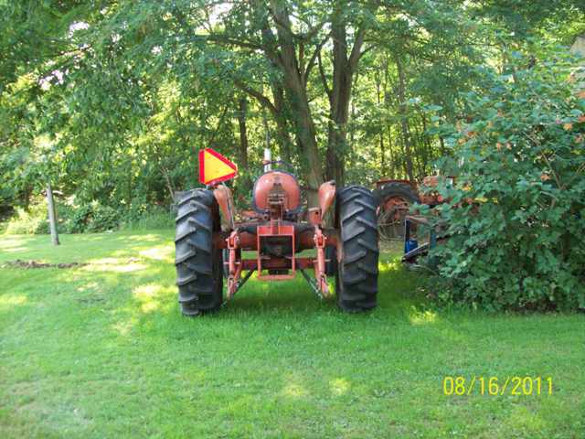

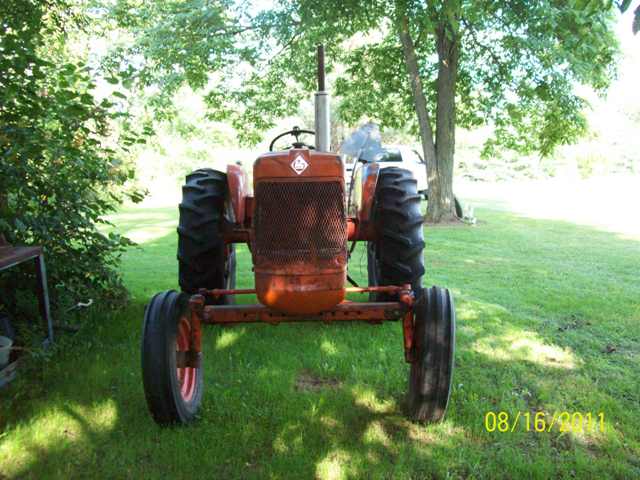

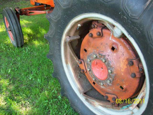

Post Options Post Options   Thanks (0) Thanks(0)   Quote john(MI) Quote  Post ReplyReply Direct Link To This Post Posted: 14 Mar 2021 at 3:38pm
This is my D14 when I had 28's on it.
IBWD MIke View Drop Down
Joined: 08 Apr 2012
Location: Newton Ia.
Points: 4191
Post Options Post Options   Thanks (0) Thanks(0)   Quote IBWD MIke Quote  Post ReplyReply Direct Link To This Post Posted: 14 Mar 2021 at 6:36pm
28's will obviously fit, as the pictures show. Only downside is you might not be able to spin them all the way in.

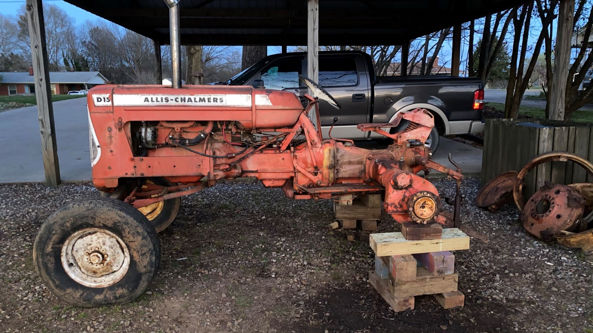

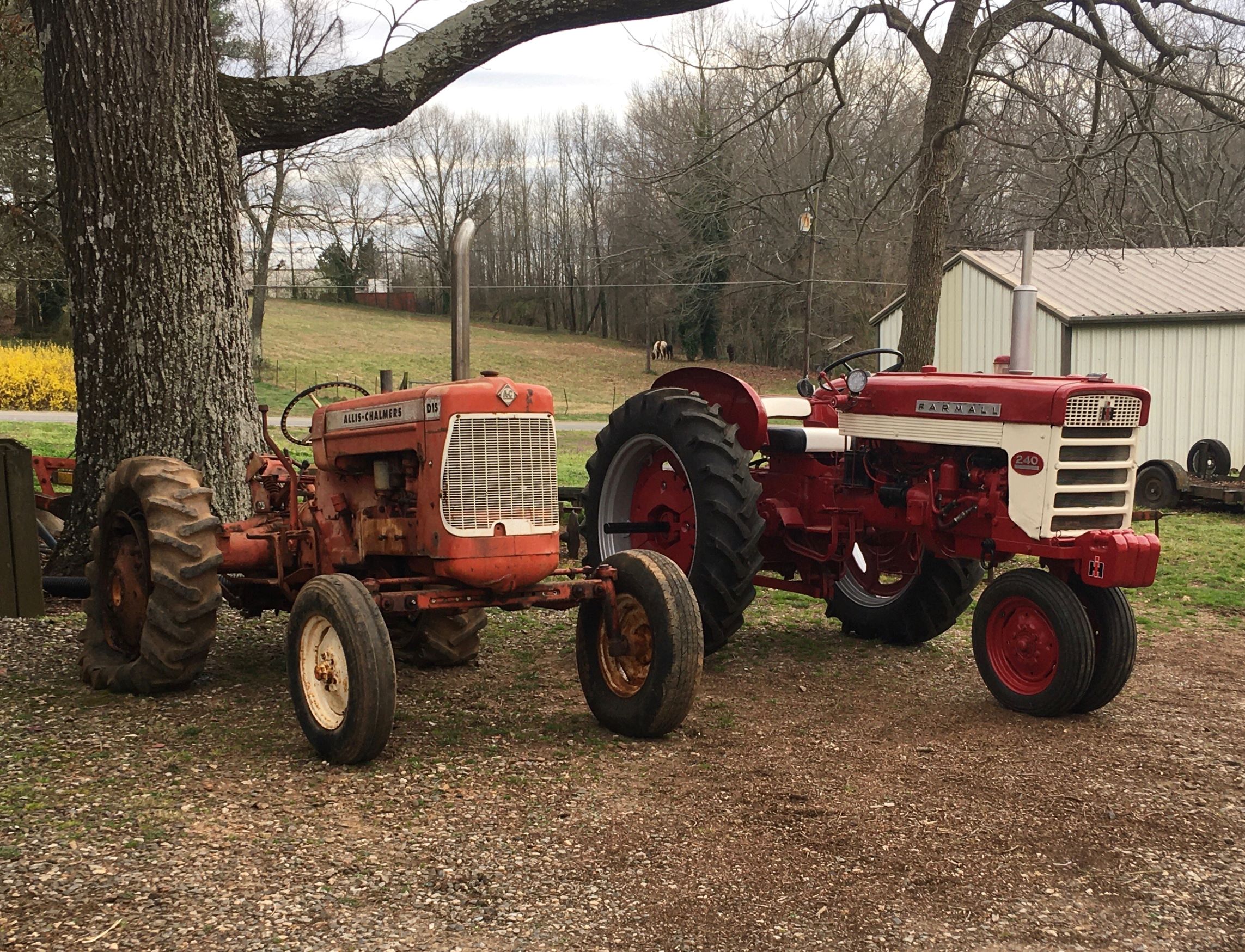

Well, we have a new-to-us D15.  It currently has 28" centers and rims on it.  The rims are more than just rust out at the valve stem, there is an 18" section of each rim that is just gone.  It must have set in a puddle of calcium chloride for years.
Engine runs well, power director and hydraulics seem to work well.  The PTO seal is gone, and the hydraulic and transmission oil levels are very low.  This will be fun to work on - we don't plant to do a full strip and paint restore, just put it back like its supposed to be and enjoy it.
Edited by NCAllisnut - 15 Mar 2021 at 12:15pm

Post Options Post Options   Thanks (0) Thanks(0)   Quote NCAllisnut Quote  Post ReplyReply Direct Link To This Post Posted: 22 Mar 2021 at 10:40am
Some progress...
And the tires to go on it came home yesterday...
www.facebook.com/AdamDavisWoodworking
