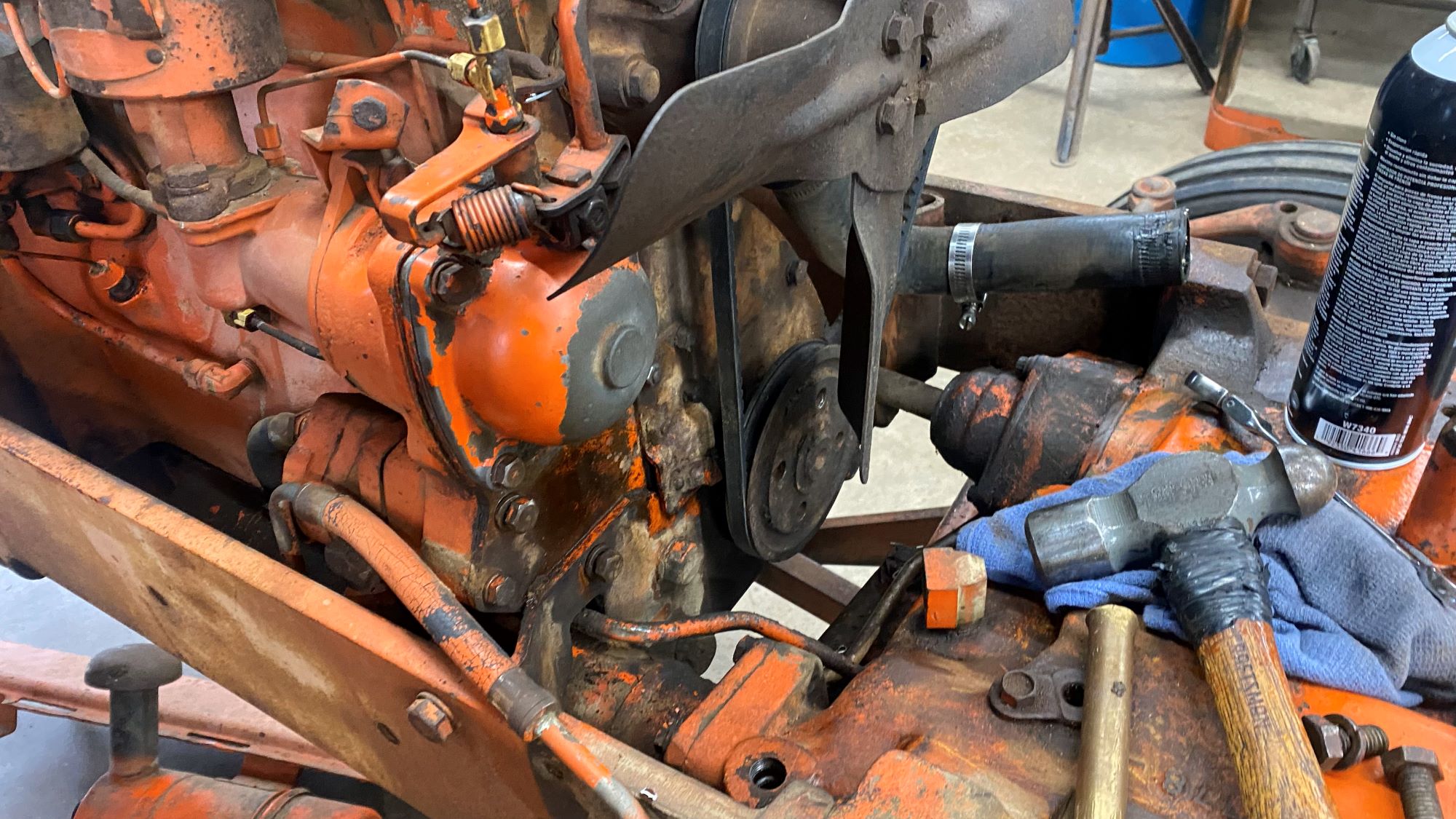

So far, the power steering pump is winning.  I tried to pull it without removing the radiator, looks like I will have to pull the radiator to get access the suction line and pressure relief line and get those out of the way.  I have removed three bolts, pump is still stuck tight to the block.
Is there a secret trick I am missing?

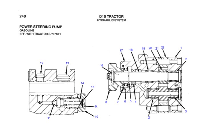

Parts book shows a different pump effective s/n 7871.

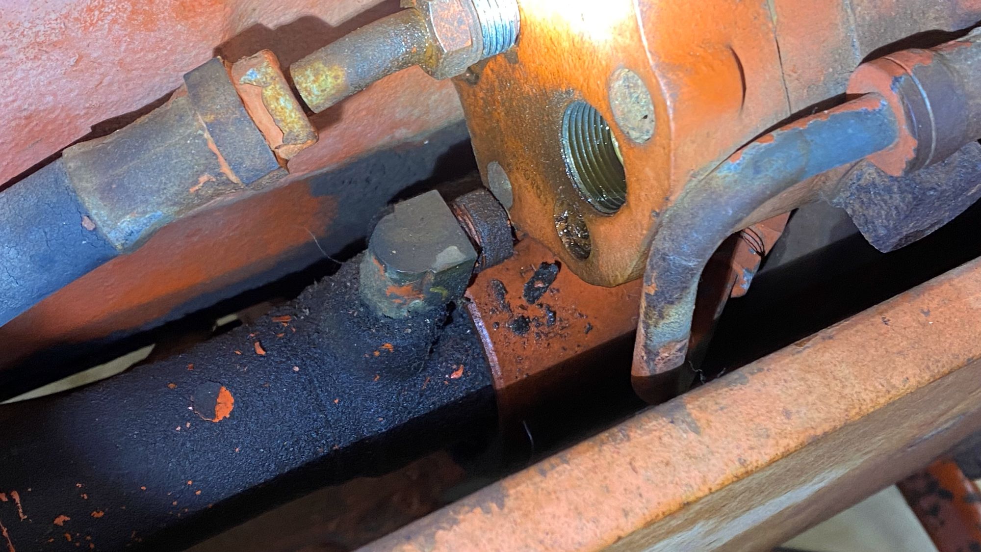

I've got the pump loose, but can't get it out of the block because of the fitting on the steering cylinder.  Decided to take a break before getting into that.

I've never fone one before, but it looks like you might have to pull the steering cyl backwards, a little, to clear that fitting... Either that, or loosen the line at both ends, and remove that elbow.  HTH
Points: 22799
Post Options Post Options   Thanks (0) Thanks(0)   Quote DrAllis Quote  Post ReplyReply Direct Link To This Post Posted: 25 Dec 2023 at 5:46pm
I'd remove the four frame bolts with a bottle jack under the bellhousing and try to drop the front support and inch or so instead of messing with anything else.

I loosened the steering cylinder and pulled it back a half inch or so, got enough wiggle room to get the pump out of the block that way.  It would have been quicker if I had removed the radiator right off the bat, instead of struggling with with poor access and then removing the radiator.
I never claimed to be a great mechanic, I can afford to be inefficient I guess.
Thanks for the guidance, and Merry Christmas!
