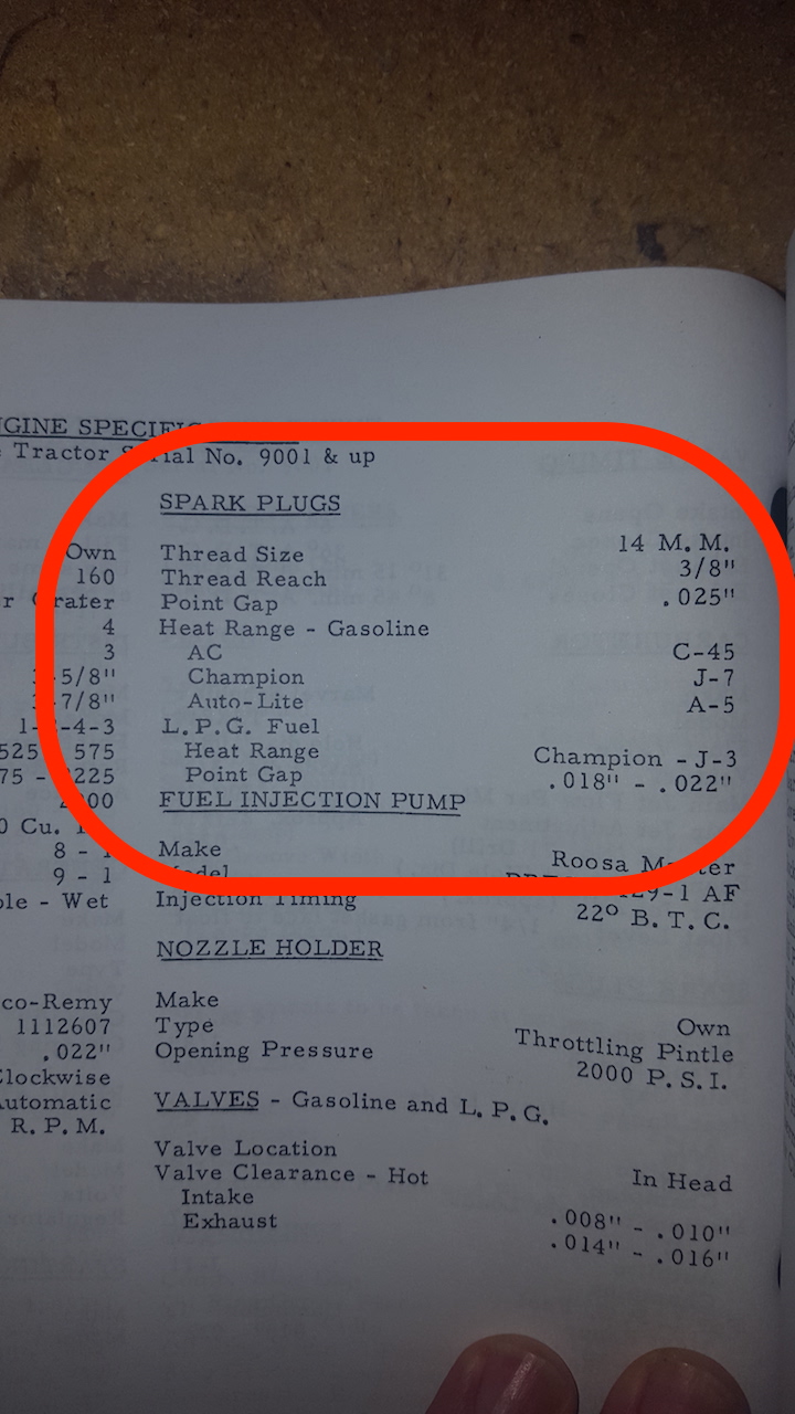

As per shop manual, SN 9001 and down (Series I) and smaller engine has two different plug options.....one for heavy loads, one for light or med.
Plugs listed for Series II (9001 and up) and 160 engine are different than either option listed for Series I.....but no load range specs. Series II has only the one set listed vs. two.
And still find it odd that for Series II, specs and data in the shop manual is only 1 paragraph or so vs. nearly 2 pages of specs for Series I. Downright scarce.....which leaves us to guess.....which is a bit scary as clearly they are not the same.

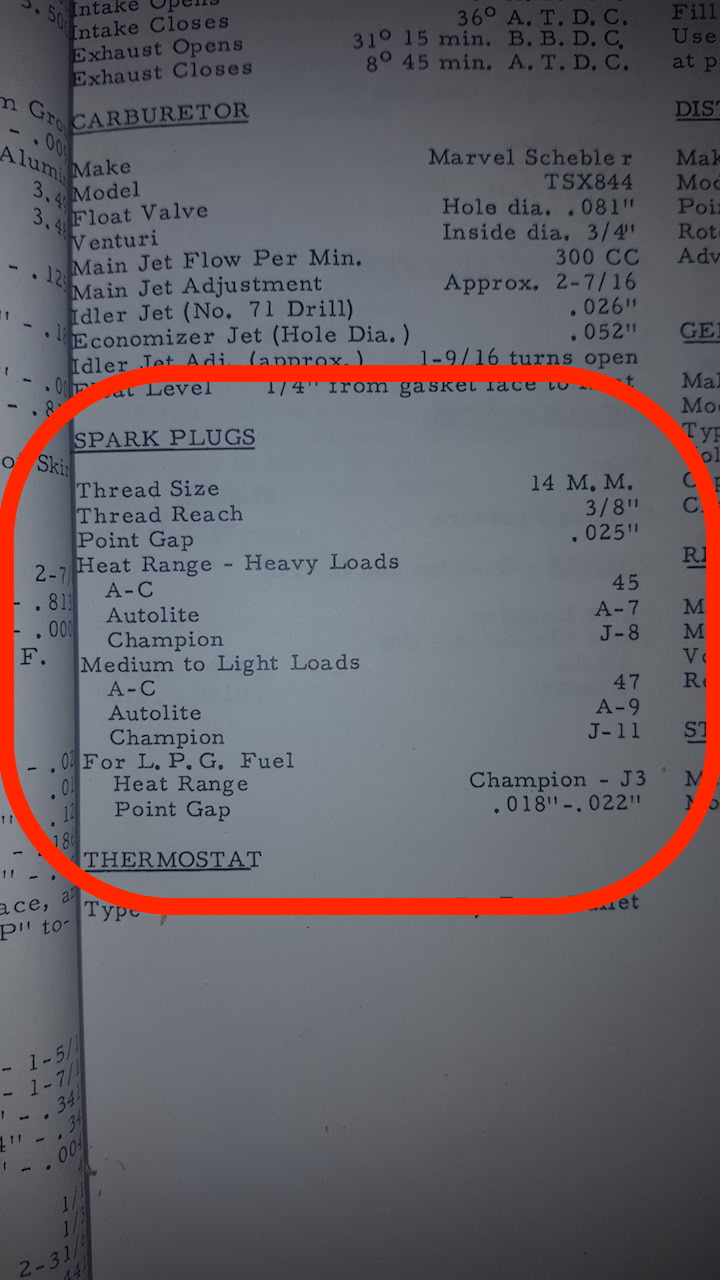

Humor me for a bit......keep in mind, I'm not a mechanic.  I've got a few wrenches and if you hand me a set of plugs, I can gap em and install em.......but ask me to explain the difference between a J7 plug and J8 plug....that is where the wheels fall off.
So here are the specs from my D15 shop manual. First for the Series 1.....second for the series 2 with 160 engine......seems to me what I ought to be looking for is a replacement plug that matches the thread size and reach, wrench size and lastly heat range. This is where the confusion starts........
So using these specs as benchmarks, and sticking with Champion plugs to be consistent,  it seems the plug for heavy loads in the the S1 was a J8. For light to medium loads, a J11. That suggests to me the smaller the number the hotter the plug? So when you get to the S2, and they call for a J7, that ought to be hotter still?
So if an Autolite 295 is a hotter plug than a 303, is that what the S2 ought to be using?
Having said that, I called my local NAPA to inquire what they showed and to check availability, and NAPA's computer said the direct replacement for a Champion J7 and an Autolite A-5, was now an Autolite 303 for both.
Leaves a guy confused and scratching his head.
