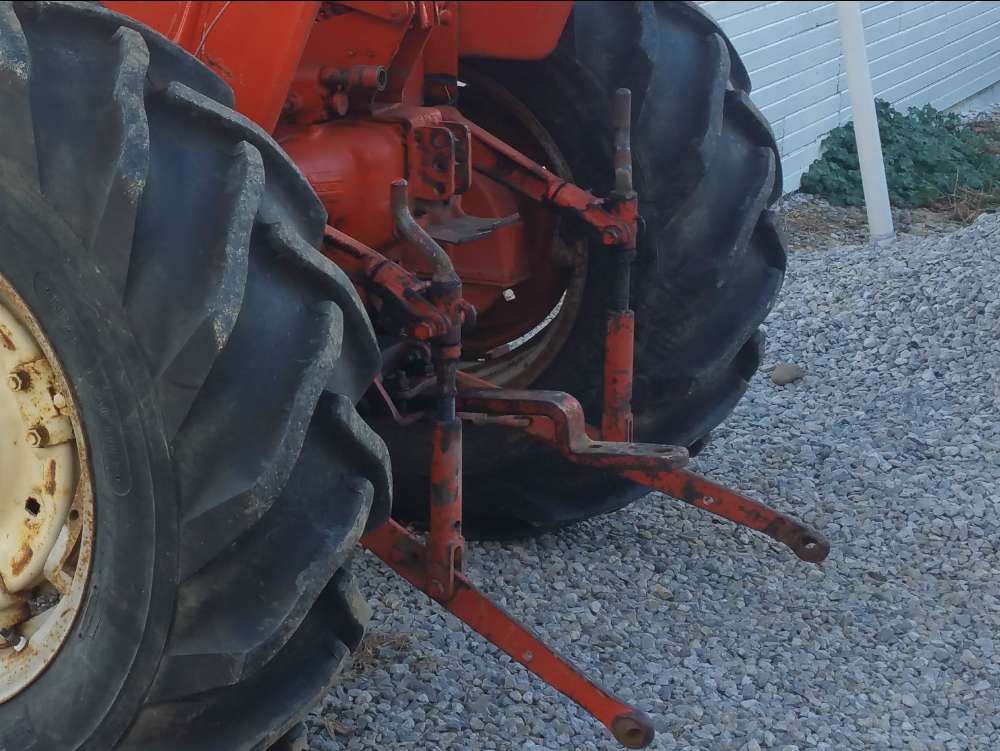

Not sure if this shows the detail you need but had this one on my phone.

Here is what mine look like.

Post Options Post Options   Thanks (0) Thanks(0)   Quote Tracy Martin TN Quote  Post ReplyReply Direct Link To This Post Posted: 02 Dec 2016 at 11:10am
Dennis, that is the way mine are. What were the holes for? Thanks Tracy
