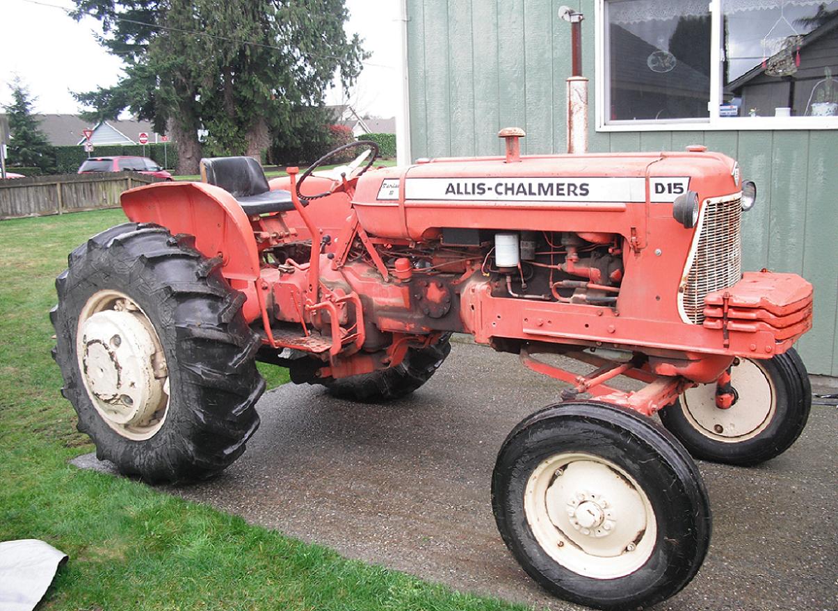

1953 CA, it looks like your air cleaner end cap is sitting on the distributor and governor.

Post Options Post Options   Thanks (0) Thanks(0)   Quote 1953CA Quote  Post ReplyReply Direct Link To This Post Posted: 26 Apr 2012 at 11:47pm
Yup, I was cleaning the filter...

Post Options Post Options   Thanks (0) Thanks(0)   Quote MBWisc Quote  Post ReplyReply Direct Link To This Post Posted: 27 Apr 2012 at 9:01am
Looks good but it makes it kind of hard to check the power steering fluid.
