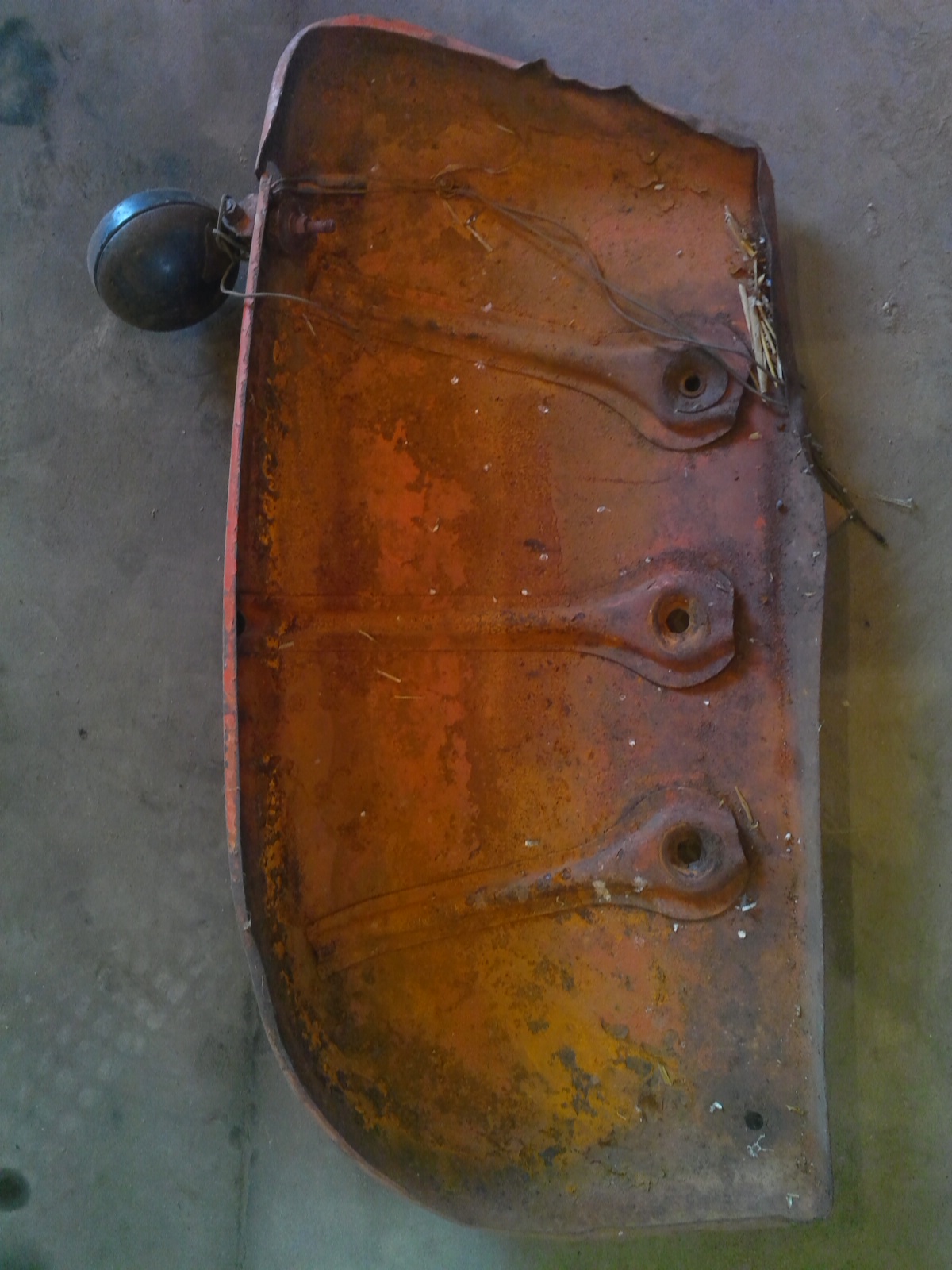

I have a set of fenders that were on a D14. They have the headlight and work light holes. One fender has a small dent by the work light hole. You have to look for it to notice it. No surface rust, no bends, as perfect as you can get. On the fence. Should I keep or should I sell.  I could put them on my early D14, but they are not correct for that tractor.
Would someone pay $700 for the set????

All D14 fenders are the same.  None of them had lights mounted on the fender (except for the bullet style tail lights on the back).  Over the years, someone probably drilled holes in them to put lights there.
I have dealt in buying and selling some fenders.  $700 for a set is out of this world in my opinion.  I know good fenders bring more money, but for that price, I would expect them to have the holes and dents fixed, painted to match my tractor, and for you to come here to install them on the tractor.

So no fenders that fit a D14 had an oval hole cut into it? One fender I have does and has the holes for the headlights. Bullet lights will not fit in this hole. I think these are replacement fenders that are not original to the tractor based on the color.
The good news is new ones are available for less money aren't they?

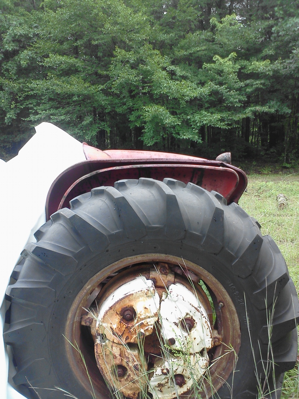

Lonn a few years ago I looked everywhere for a ser of replacement d15 fenders and they just didn't make then. Mine where truly beyond repair all the ribs rusted to nothing at all falling off the tractor and dented just junk so I bought a set of d17 reproduction fenders. They are close enough for my tractor as it is a work tractor and I mostly just want a place to put my hand when driving.

My d15 has a loader and the fenders are mounted out on the loader hangers to give me more room or they will be pretty soon so everything is custom. But you do have to modify the setup to hang them the ribs on the d17 fenders are different even though the overall size is about the same. I had a picture once of the two fenders one sitting inside the other almost the same length but the d15 curls in more at the top and the d17 has more of a corner.

D17 Fenders are bigger than a D14.  D17 and 19 fenders are the same.  D14 and D15 fenders are the same (except for the headlight mounts for the D15 II).  D10 and D12 fenders are the same - modified versions of the D14 fender.

Post Options Post Options   Thanks (0) Thanks(0)   Quote Dan73 Quote  Post ReplyReply Direct Link To This Post Posted: 17 Apr 2016 at 8:27pm
That is a d15 fender sitting inside the d17 fenders on my d17 I figured it was close enough for a working tractor after looking at it for a while.
