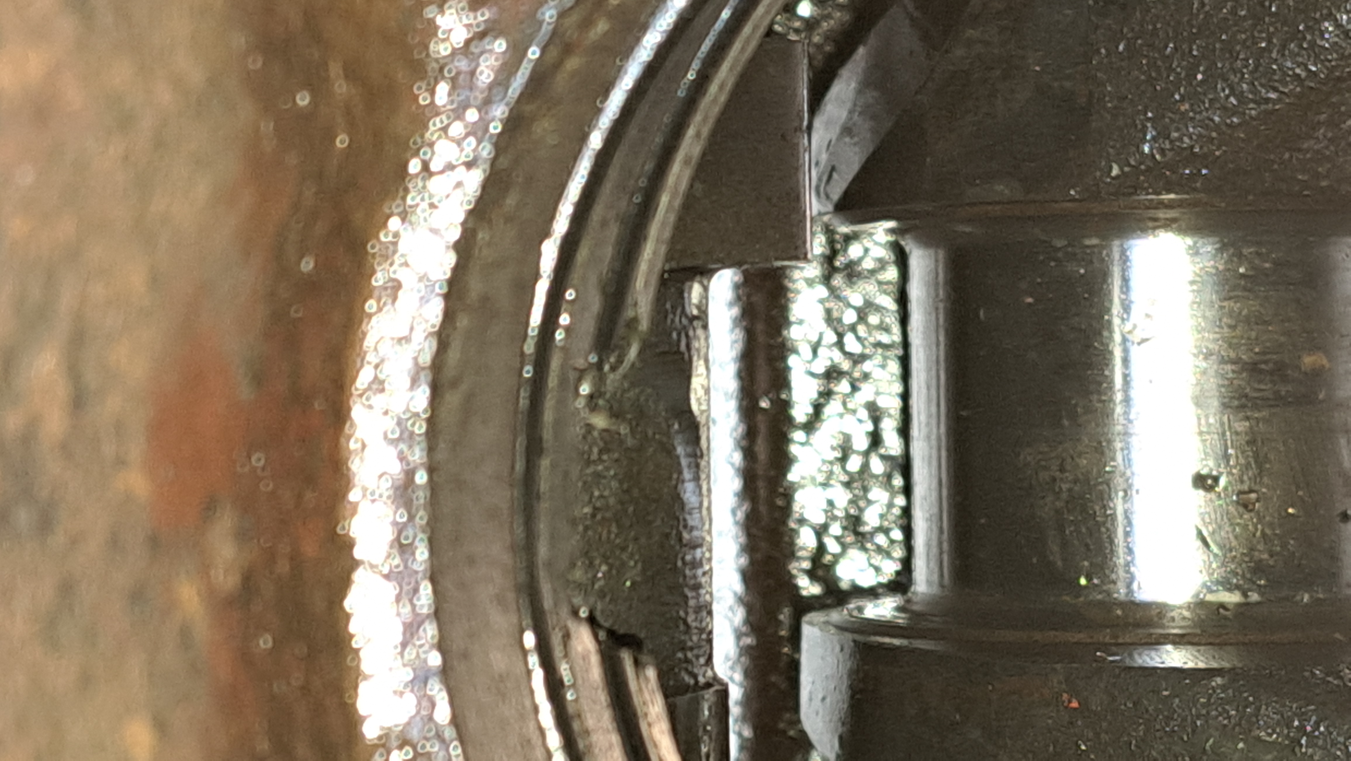

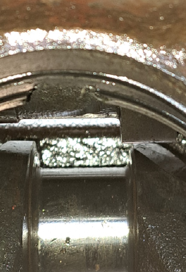

My D15 broke the connecting rod and I didn't notice the damage to the block at the lower o ring. Can this be reassembled with only a single o ring? If not is the block repairable?

There are two o-rings on a liner for a good guarantee that there will be no leaks... You COULD use one o-ring and get by if everything goes GOOD on the assembly and forms a good seal... There is no guarantee and nobody will be able to tell you for certain that it will work....  Long term, if you do it and then have a minor leak, you could put in some radiator sealer and let it finish things up.
Many will complain about the nick in the journal.. That will not hurt as long as it is cleaned up and nothing sticking up above the round surface.. I would be more concerned about the journal being ROUND ..... Before going ahead with the crank and block, i would inspect everything very good to make sure you found all possible problems.

I assume that is a G-160/ Series 2 engine ?? Anyway, no one can repair that block as cheaply as just finding another block.

Steve the engine got a comple overhaul kit put in it about 3 years ago. The crank was inspected then and everything measured good I installed all new sleeves and pistions at that point the motor was completely gone through. This started with a broken ring causing blow by I figured it would be ok to use it for a few weeks work I needed which proved wrong. As the rod broke at the wrist pin end.
Dr,Allis the motor is definitely a 149 I made the mistake of ordering the 160 kit for it when I rebuilt the motor. The tractor was built out of 2 parts machines and the motor is serries 1 the first year of production iirc .
