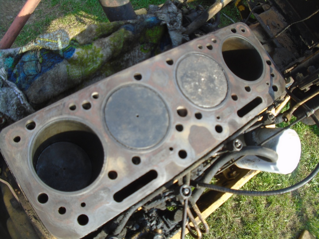

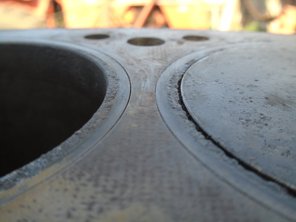

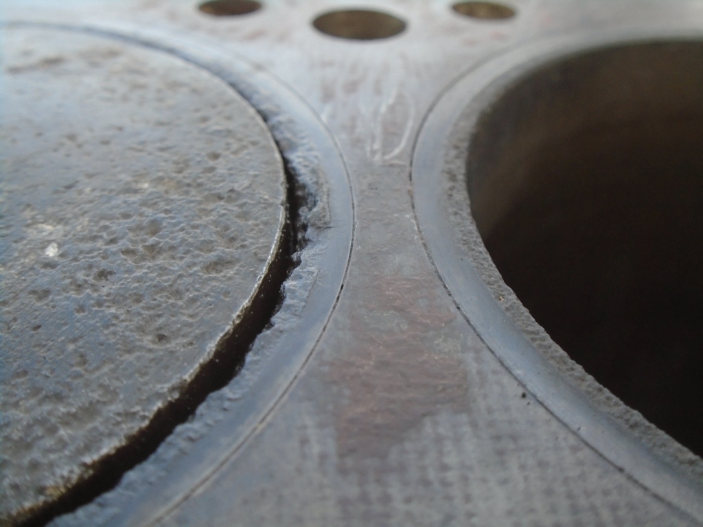

My hybrid d15 diesel project tractor: I had to take the head off because when I got an exhaust valve unstuck, I must have knocked some rust off the head and I could not turn the engine all the way over anymore. I was surprised at how good I thought it looks. I was expecting to see cracks and sunken sleeves, but it doesn't seem to be the case. I will do some work on the head though. I believe this is the 4cyl version of the D19 diesel engine? Looking for opinions from the guys that deal with these diesels if this looks ok?

That engine has definitely taken on some water in its past from the pitting on those pistons.  I would at least hone the sleeves and check the bottom end out while you are at it.
