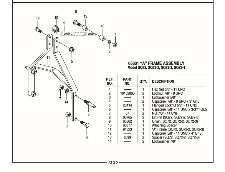

Besides a picture with the bar installed bow up, I found this in one of the Squealer parts manuals.

That's interesting jim.i see pictures with that cross bar both ways. That
might help the pto interference.

To me it looks to me like the cross bar might be upside down. Bow in the bar up and the PTO shaft under it might look better. If you can find any more of a model number to go with the Bush Hog Squealer You can likely get a book for it from Bush Hog.

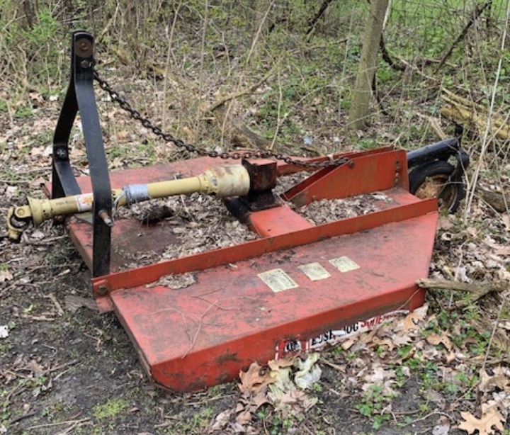

My tractor isn’t here. Here’s the mower. Looks like I can adjust the rear wheel. That bar that goes across the 3 point is what the pto has hit in the past. Looks like previous owner just lived with it.

Does your cutter have the tail wheel on it? That should be set to carry the rear height a couple inches higher than the front level, which your limit chains can control, then grass should come out under the rear. How about posting a photo of your set up? Someone might see something to help, if we can look at it.

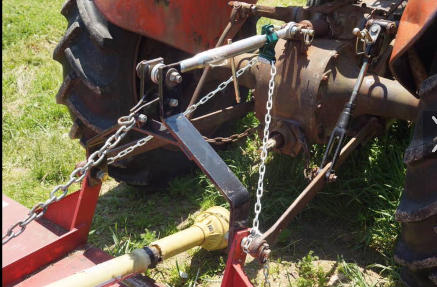

The more I look at this pitcture the more I'm thinking that top link is causing my frustration. If I get the back of the mower up it should be better I'd think. Should the mower be lever or with the back up higher like 6 or 8 inches?
Iv tried to shorten the chain a little but maybe I need to do more,like a foot.
If you want a better chopping action, the rear should be lower than the front. Level is what it's "supposed" to be, but I generally adjust my top link so the rear is maybe 2-3" higher than the front. Supposed to use less power that way.

Another problem I have is the higher I lift the mower the more closer the pto gets to the deck. In fact the previous owner has the plastic pto cover rubbed in to. It's all ducked taped and looks like hell. I tried to shorten the chain that runs to the back last year, that's not the answer. I'd like to be able to cut taller.

I found this picture on the internet. This is almost my exact set up with limit chains added.

What mowers do you guys like behind these old tractors? I have a 5ft
3pt bush hog. It's never been very good. Wants to drift down and is a pain in tall grass. I've always thought a pull type with fixed height would be better. Maybe a 6ft ?
Father inlaw told me to cut th back skirt off. He might be right as it seems like grass doesn't exit good.
