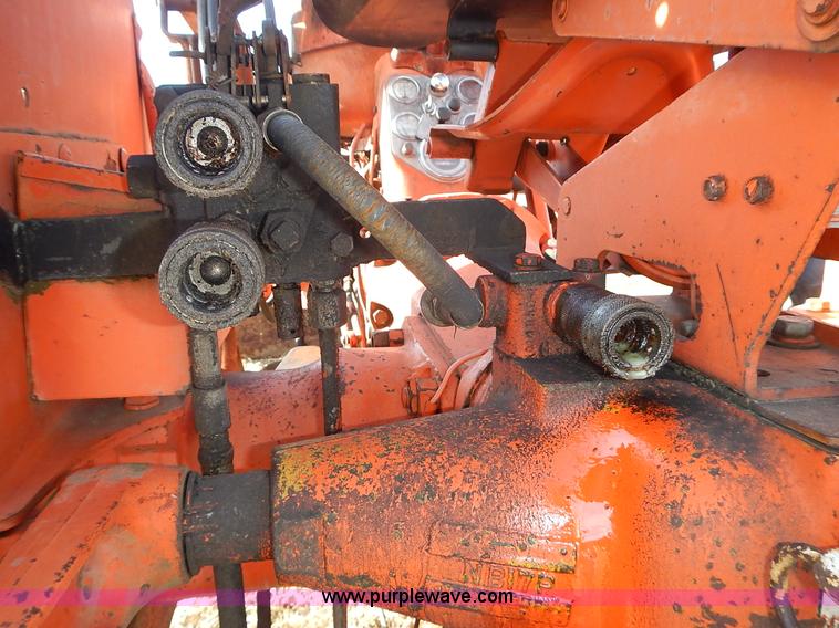

I’m wanting to add auxiliary hydraulic valves to my D15 so I can run a two way cylinder. If I’m doing the work I would like to pipe it so a second spool would control the lift arms. If I pipe the second spool valve back to the original aux. valve (like the one in the picture) would this control the lift arms up and down? I realize I still would have no draft control but I’m hoping to get better/smoother height control of the lift arms. I realize I would have to pipe the current supply line to an open center control valve, run a return line back to the sump and have to put the original control lever on the console in the up position. Would this work achieve what I’m wanting it to do?

As far as the return line goes, there is a plug, on the left side of the torque tube, about shin high, when seated in operators position, that  can be used for the return, IIRR...Wink

You cannot connect two individual aux valves like christmas tree lights, one after the other. You probably will explode the first valve when you pressurize the second valve to max press. Get a 2-spool valve and you can do exactly what you want without issue.

Thanks Dr.Allis, I should have been more specific. I would install a two spool valve, not install two individual single spools. I don’t want some cobbled together looking mess of valves! I know Allis made a single spool and three spool option (single one on eBay right now) but I would guess I’d be hard pressed find a three spool factory valve.

Ideally, you should try and find valves that have a "float" position in them, especially for the lift arms. That type of valve will cost more but will operate soooo much better.
