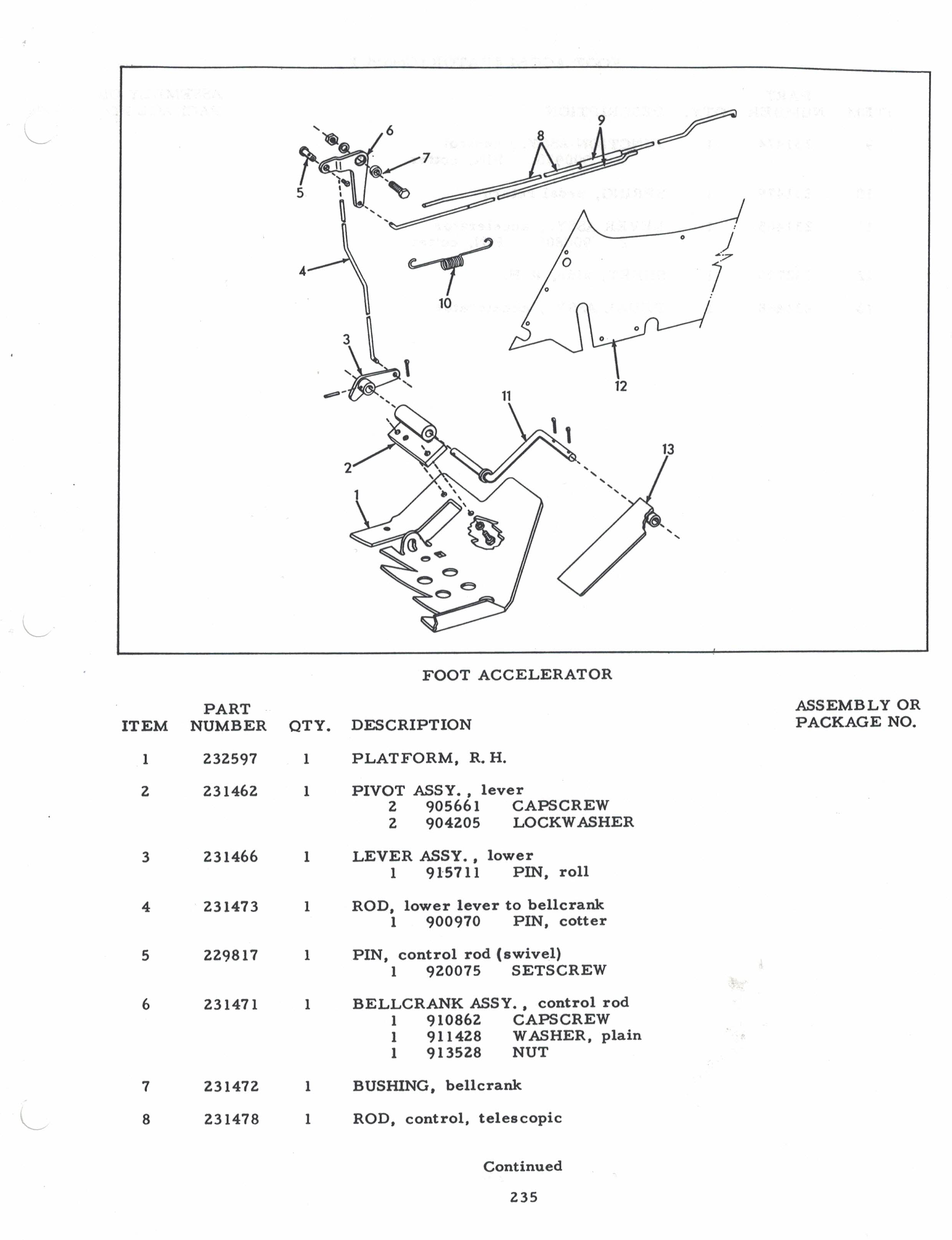

Does anyone have a pic of where the D14-D15 foot throttle spring attaches to? I can't figure out where it goes. This is all I like with being finished up. I have searched all over with no luck.Trying to figure out the size and length. Any help appreciated! Thanks, Tracy
Points: 25228
Post Options Post Options   Thanks (0) Thanks(0)   Quote jaybmiller Quote  Post ReplyReply Direct Link To This Post Posted: 05 Feb 2024 at 5:01pm
this OK ?
Location: Gallatin,TN
Points: 10926
Post Options Post Options   Thanks (0) Thanks(0)   Quote Tracy Martin TN Quote  Post ReplyReply Direct Link To This Post Posted: 05 Feb 2024 at 5:08pm
Jay, I have that diagram. I was wondering where the left side of spring hooks to. The right side hooks to the small vertical hole in rod #9. I think the left side hooks to the cross over strap that is welded to the fuel tank support and dash cluster bracket. I wanted to get the springs made as true to original as possible. Someone probably has one installed but I don't know of one personably. Thanks, Tracy

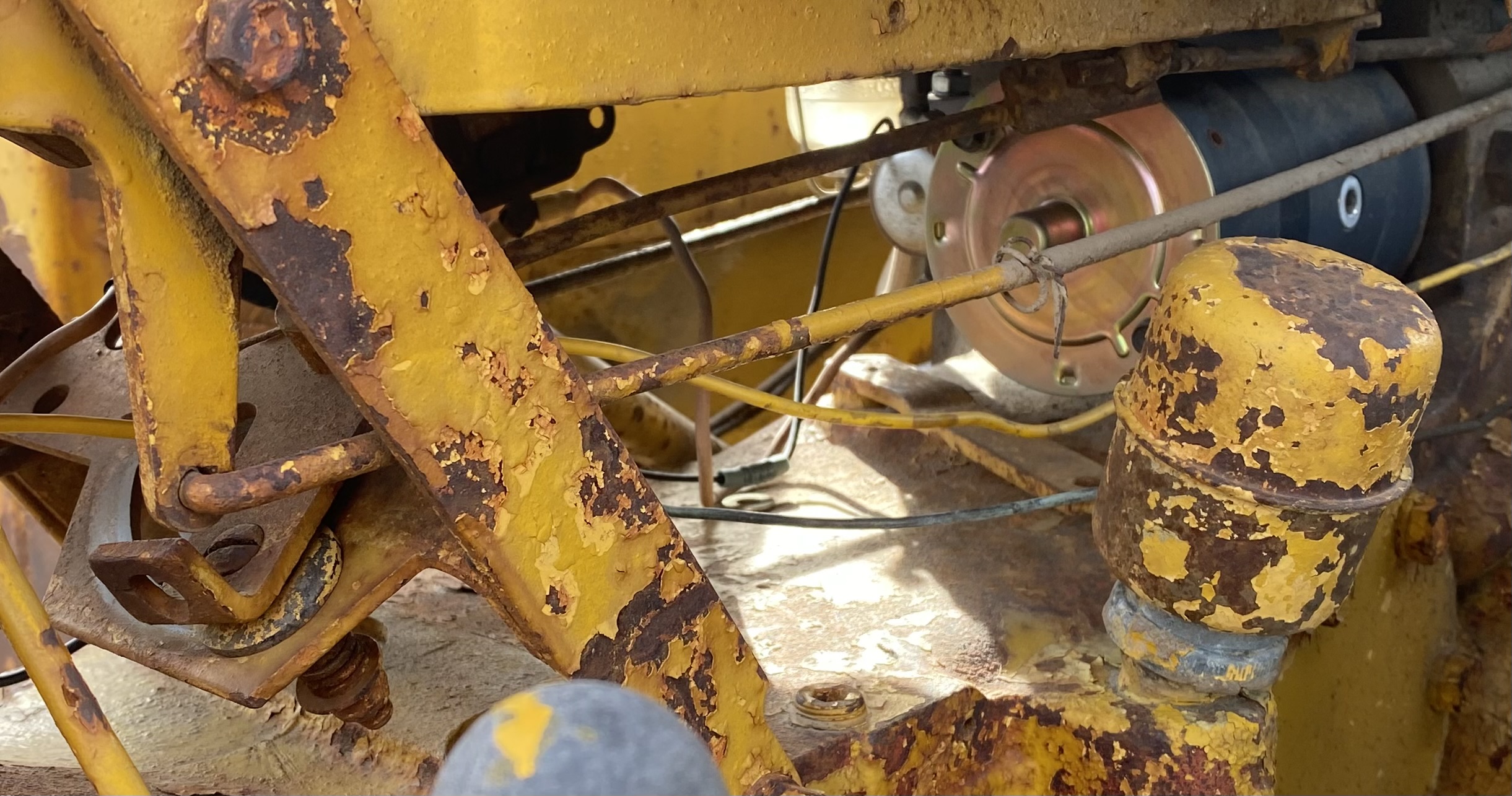

So it would seem that my spring is MIA, but I would guess it attaches to the brace down by the throttle pivot with the friction material.
Points: 22790
Post Options Post Options   Thanks (0) Thanks(0)   Quote DrAllis Quote  Post ReplyReply Direct Link To This Post Posted: 15 Feb 2024 at 6:17am
That would be the counter-balance spring, which is on all tractors, foot throttle or not.

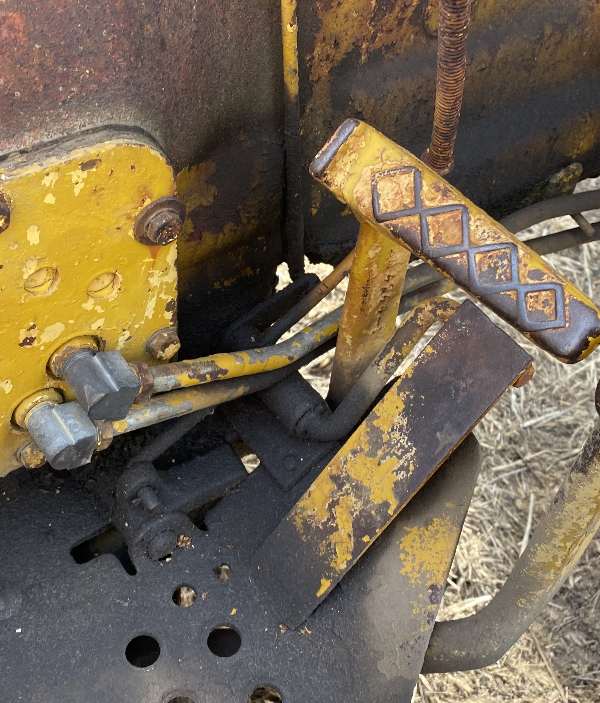

Travis, I would like to see the pedal and the bellcrank in a better pic. Yours looks like a industrial with spring bracket missing. Tracy

I'm out of practice and not good at getting pictures to post here... Pinch
Travis(NE) View Drop Down
Joined: 24 Sep 2009
Location: Seward NE
Points: 300
Post Options Post Options   Thanks (0) Thanks(0)   Quote Travis(NE) Quote  Post ReplyReply Direct Link To This Post Posted: 03 Mar 2024 at 10:36am
