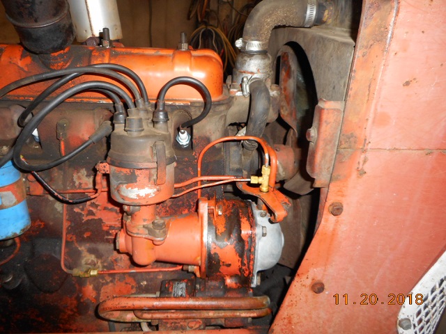

Post Options Post Options   Thanks (0) Thanks(0)   Quote Jim.ME Quote  Post ReplyReply Direct Link To This Post Posted: 14 Feb 2019 at 11:52am
The bypass hose goes between the water pump and thermostat cover.
I believe it is common for a temp gauge to be at the hottest location on an engine. You may have some build in the head restricting circulation as part of the issue.

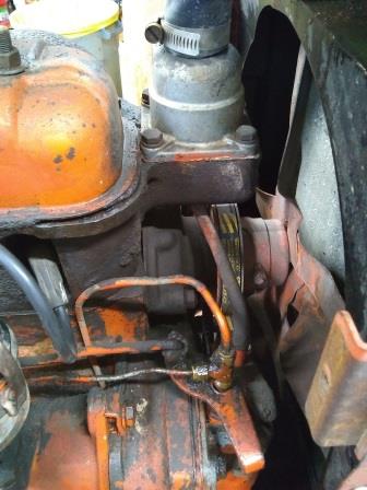

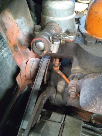

The water pump does not have the bypass port on it. I guess that is why they plugged the bypass port on the thermostat housing, and looks like they put it on wrong direct versus Jim's picture. Here is what it looks like. Plan on replacing the thermostat this weekend and see if that helps.

Post Options Post Options   Thanks (0) Thanks(0)   Quote Jim.ME Quote  Post ReplyReply Direct Link To This Post Posted: 14 Feb 2019 at 8:23pm
If the new thermostat doesn't have a bleed hole in the valve, drill one to vent the air out of the block.
