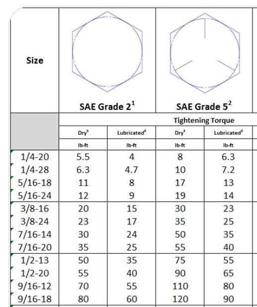

I’m replacing my manifold on my D14. My IT manual doesn’t give the torque specs for the manifold nuts. Google says 20-25 foot pounds, wanna verify that’s correct? Have a new gasket but I need to pick up some brass nuts to replace the old ones.

your in the right range... Here is the chart for STEEL NUTS.. if you doing brass or aluminum i would use the GRADE 2 column, not the grade 5..
