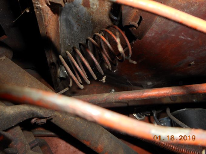

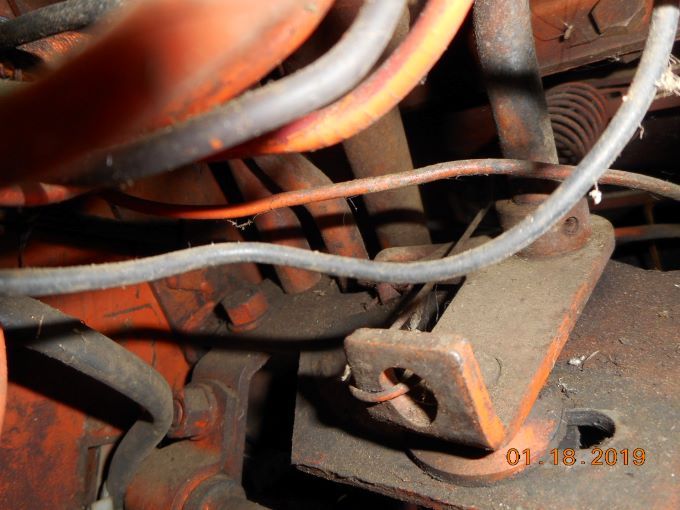

Broken D 15 spring post of mine back in January Jay . I'm thinking Jim was nice enough to post pics of it . Good luck

Post Options Post Options   Thanks (0) Thanks(0)   Quote Jim.ME Quote  Post ReplyReply Direct Link To This Post Posted: 13 Sep 2019 at 9:38pm
I think this was what I posted. HTH

Post Options Post Options   Thanks (0) Thanks(0)   Quote ACinSC Quote  Post ReplyReply Direct Link To This Post Posted: 14 Sep 2019 at 5:23am
That's it Jim . It's under the gas tank . I'm thinking it's a $40 spring . Thanks

The Parts Catalog for D-14 and 149 Power Unit illustrations both show the spring to be going straight up.
May be hooked to a manifold bolt.
Sure would take an awful long spring to hook under the gas tank.

Post Options Post Options   Thanks (0) Thanks(0)   Quote DrAllis Quote  Post ReplyReply Direct Link To This Post Posted: 14 Sep 2019 at 7:38am
That is a different spring for governor surge issues. Two different springs and two different locations.
