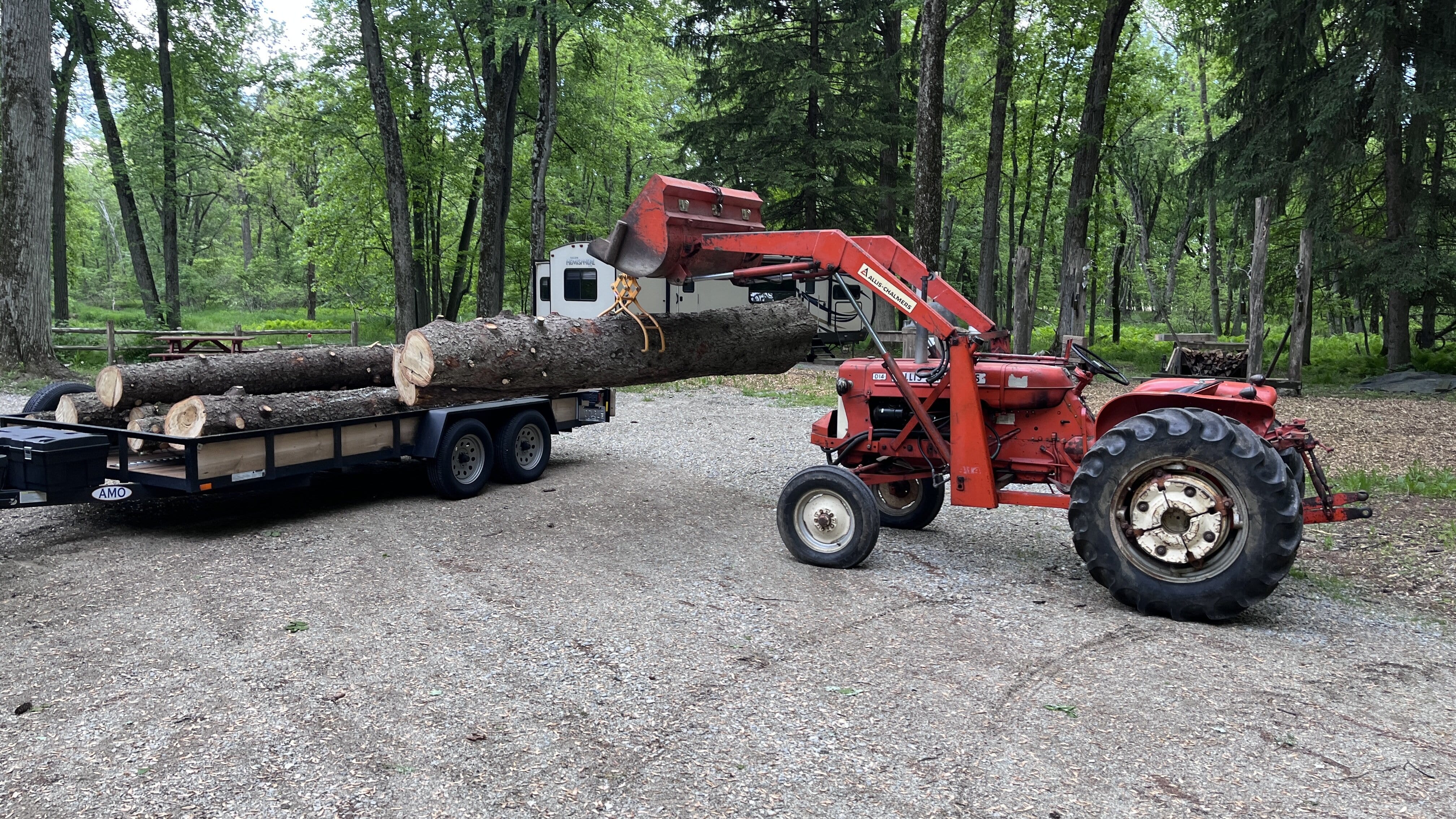

Pretty new to the tractor world but I am a proud owner of a 1960 D14 with a 414 loader. It’s been great so far and we mainly use it for moving logs around in the woods and over to the mill. I want to upgrade the front tires as they are old and so much pressure on them when lifting logs. Looking for recommendations on a tire size and type with high load range. Everything we do with the D14 is low speed so not too concerned about having too stiff of tires unless someone tells me otherwise.

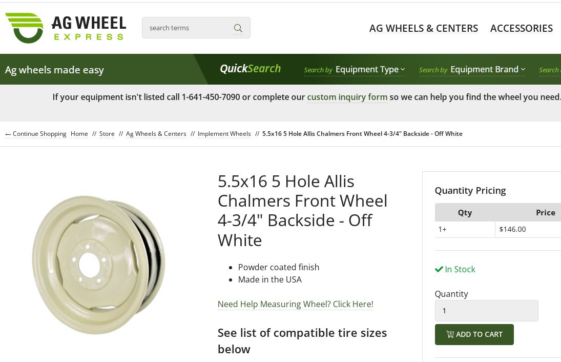

your rims should be 4.25 x 16 i believe and the tires would be 6 x 16 or 6.5 x 16 inch ?  Most of those 3 rib tires are rated like 12- 1500 pound each ??
You probably want a different design tire... and might need a wider rim also... should be 5 bolts on 5 inch circle.
Thats a pretty big load for a D14... Have you checked the front axle /rims / bolts for problems ???

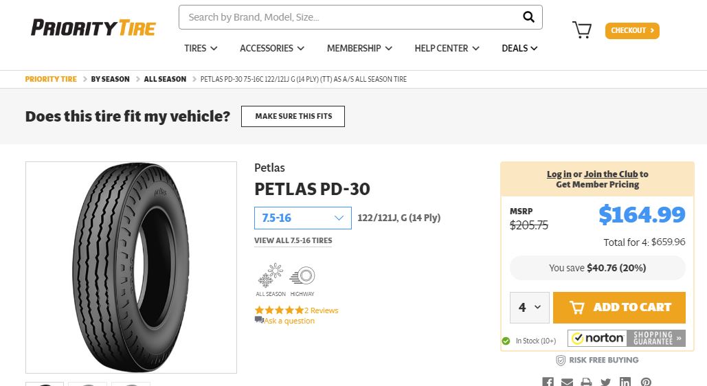

I bought a pair of these 14 ply tires for a CASE 530 Backhoe a couple years ago. I think they were rated at 3500 Pounds each.... they also had 8 ply same size and they were 1950 pounds each... These have worked out well for me, but i have 5.5 or 6 inch wide rims, not the 4.25......

wider rims for 7.5 inch tires .............. verify the offset prior to purchase to make sure they dont hit your spindles / alxe...

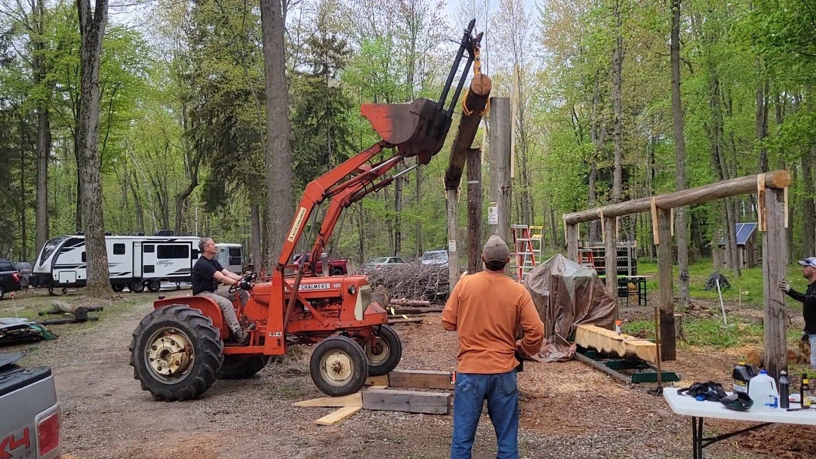

Thanks again everyone. I definitely will do some inspecting on the front end next time I am up north near Allis. I know the front end width is adjustable on these tractors. Am I better off having the front set to the widest setting for what we use it for? I am honestly not even sure of the current setting. One of my favorite pics while building our mill shed.

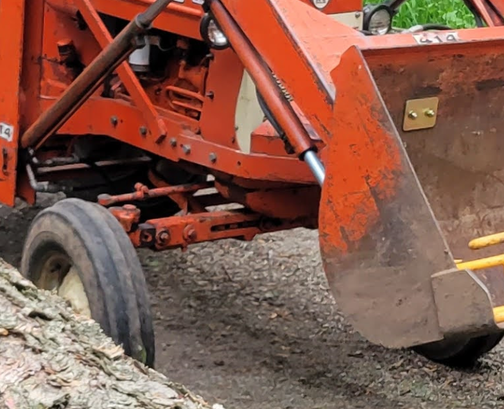

Found this. Looks like it is one hole out from the narrowest setting to me.
