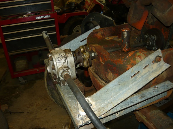

here is a few pics of the brackets, pump and drive hub.  the drive hub is for a ford/sherman 54c2055 the pto is for a 8n 3/4x13" 194354.  the parts that attach the pump to the shaft came off a junk loader from a ford 8n.  In case your wondering, I used the ford drive hub because the one for the allis had 10 splines and the pto that matched it was only 10" long and wouldn't be long enough to make it through the  bollister.  still have to clean up some welds and grind off any sharp corners.
The bolt pattern from the ford drive hub was a perfect match for the allis. a 8n drive hub will not work, the bolt pattern is to small as are the bolt holes.  I installed the radiator and ran the tractor for several minutes to make sure every thing worked.  then had to tear the radiator off to start making brackets for alternator.

the pump is also from an 8n wagner pipe loader that i got laying here.

Post Options Post Options   Thanks (0) Thanks(0)   Quote Pete from IL Quote  Post ReplyReply Direct Link To This Post Posted: 28 May 2017 at 7:38am
Looks good. On the top picture I would think the drive flange connected to the drive shaft should be bolted to the holes that are open on the flex coupling. The way it is bolted there I don't think the flex coupling is doing much good. Thanks for the pictures'

Post Options Post Options   Thanks (0) Thanks(0)   Quote dt1050 Quote  Post ReplyReply Direct Link To This Post Posted: 28 May 2017 at 8:03am
thanks, have to tear the stuff apart to put the tractor back together, I'll change the bolts on the flex coupler then.  probly get some orange paint for the brackets as well, not sure it'll stick with the galvanized metal....man that stuff stinks when ya weld it....but it's what I had laying around.

How thick is your braket

3.5mm thick, under the pump there is a piece of 1/2" steel.  sure seems like galvanized fumes are unhealthyDead

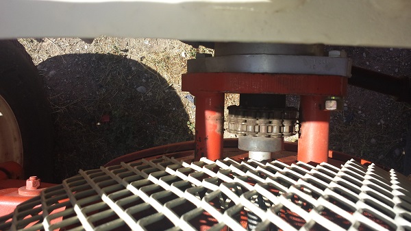

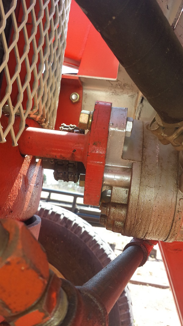

Our front mounted pump, for a 200 industrial on a 17, has a chain gear on it and a gear on the end of the shaft.  It is coupled with a double chain.  Also the shaft is held in by bolts in the 2 bolt holes there on the front of the tractor.  We had to get new pieces, i think from someone in Iowa, because ti was welded on the 14 that it was on.  So, we didn't have to build that support on the front.  Sorry no pictures.

Post Options Post Options   Thanks (0) Thanks(0)   Quote dt1050 Quote  Post ReplyReply Direct Link To This Post Posted: 29 May 2017 at 3:25am
I scratched my head for hours trying to figure a way to mount the brackets to the holes in the front of the tractor, but nothing seamed strong enough with out some sort of side braces.

Post Options Post Options   Thanks (0) Thanks(0)   Quote desertjoe Quote  Post ReplyReply Direct Link To This Post Posted: 29 May 2017 at 9:59am
   Hey DT,,,I'm thinkin maybe your brackets are a tad light duty,,,,cause they gotta be strong enough to resist the rotational forces of the engine,,,? I will get some pics of the bracket on my D14 Industrial that uses the two bolts on the front. I can see one of em in your pics.
