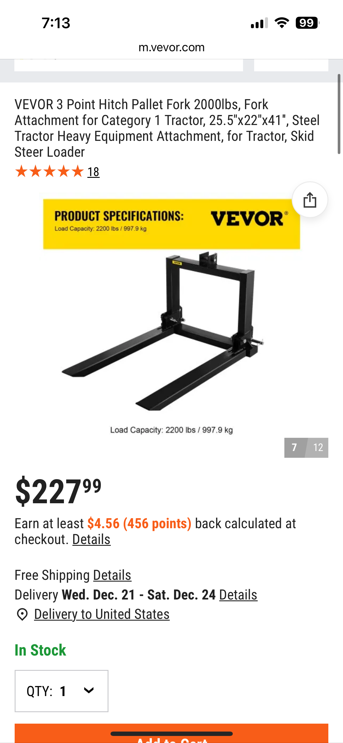

That’s pretty awesome. I thought about building something similar since we already have the clamp on forks. Otherwise I was just gonna buy this: With the loader on the front we will be able to pick up something for counterweight I was just worried about the 3 point being strong enough to lift the weight with it being put away from the pick point a bit. IMG_6194.png
Points: 25237
Post Options Post Options   Thanks (0) Thanks(0)   Quote jaybmiller Quote  Post ReplyReply Direct Link To This Post Posted: 20 Dec 2023 at 8:04am
gee for $250 that's a pretty good deal .
Since I get steel for free and my time is 'free', I've always liked to 'bodge' instead of ,yuck, buy..
Whichever way you go, be sure the load can't hit the rear tires !!! BTDT..it becomes 'interesting' !!

Butch, I do exactly what you're suggesting with my D17.  I have a homemade 3-point kit, and a face mount that has standard forklift forks on it (yes, they slide from side to side, which you'll eventually want).
I use this setup for moving pallets and IBC totes all the time.
I'm certain that the smaller D will be just as willing to lift... but beware... an IBC tote full of green wood hanging on the forks will give your lower radiator a very clear view of the sky.  I usually have to hang a bunch of assorted ballast on the nose of my 17 in order to keep the wheels close enough to the ground to provide a little direction.
It is wise to lift the tote JUST ENOUGH to clear the ground, just in case you wind up nosing up, it will cease climbing when the forks touch the ground.
I've lifted over 3000lbs with my D17's forks on 3-point... just enough to get it off the ground, then steer with brakes, it'll move LOTS.  Now, it won't lift really high, but if you put a loading-berm in your yard, you can back a pickup up to it, and then bring the forks over to set a tote in a pickup.  I have three forklifts, and the one thing that the Allis CAN do, that the forklifts simply cannot... is traverse soft ground with that load.
Sliding forks is a good thing... if you can save the Vevor coin and just fab your own mounting face for a pair of used forks, do it.
