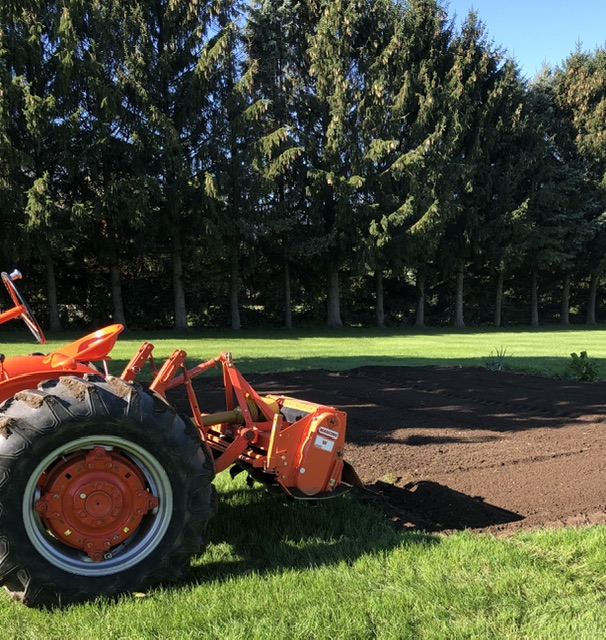

I make at least 2 tilling passes in opposite directions.
The 1st pass is at 1/2 throttle, and the final pass in the opposite direction at full throttle!
It is much easier on the equipment and hopefully do not find anything left buried in the ground!
The CA can handle the 4 ft tiller fine!
Tire tracks are to the outside and not a problem!
Location: Gallatin,TN
Points: 10927
Post Options Post Options   Thanks (0) Thanks(0)   Quote Tracy Martin TN Quote  Post ReplyReply Direct Link To This Post Posted: 20 Sep 2023 at 10:45pm
That looks great!Tracy
