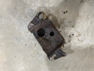

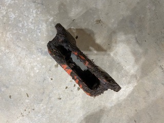

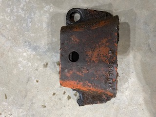

I'm looking for this hitch part for my D12. It bolts to the bottom side at the front of the drawbar with two big bolts. I can't find the broken piece of the ear to try to repair it. anyone have one for sale?

part number: 70236372
I haven't had any luck finding one, hopefully someone can help.

Drawbar support bracket.  A machine shop can build that up.

I’ve been reading about welding mild steel to cast steel and Think I’m going to try making that corner out of mild steel and welding it up.

I have had very good results TIG welding cast steel AC parts to mild steel.
