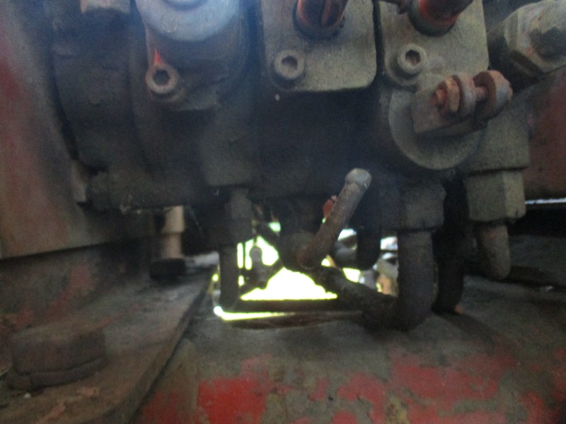

Jeff,
If you are not going to run the line to the traction booster gauge, you will need to plug the outlet for the line that is located on the front side of the control valve under the control levers.  In the picture below, the line has been cut and soldered.

Post Options Post Options   Thanks (0) Thanks(0)   Quote Jeff K Quote  Post ReplyReply Direct Link To This Post Posted: 06 Sep 2016 at 3:53pm
Thanks for the pic Larry. That is exactly what I needed to know.
