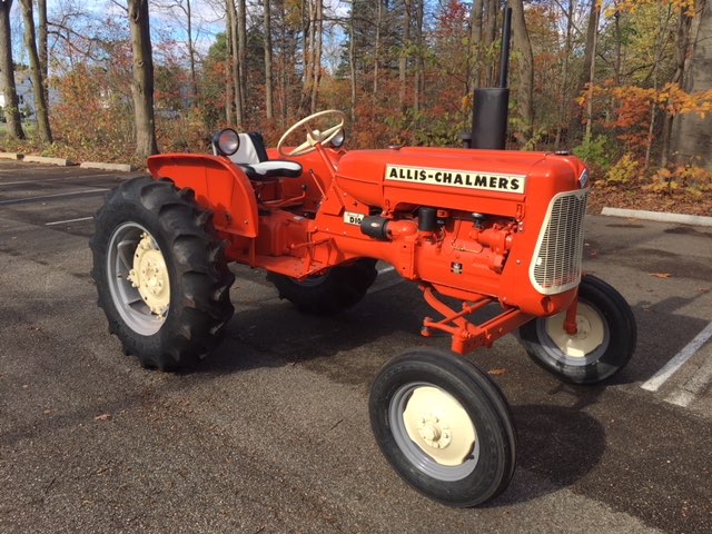

Guys, I am buying tires for my D10 Series 3 restoration. I am going with Goodyear tires. I am deciding on 12.4/24's or 13.6/24's DynaTorque II's on the rear and I am going with a 3-rib front from Goodyear.
Problem is I threw away my old front tires and I do not remember what size they are.
I think they are either 15's or 16's and I really don't know how to measure the rim correctly.
Am I looking for something like a 5 x 15 or 5 x 16. Can you guys help me with some knowledge?
Thanks :)

  Tractor Data' says fronts were 4:00 X 15
Gary
< ="" ="text/">setTimeout("waitForPageRender()",5000); http://www.tractordata.com/farm-tractors/000/0/1/14-allis-chalmers-d10.html

15" fronts.  I put 14.9's on both my 10 and 12.  Looks real beefy, and it was a standard size...

I have 14.9's on my D-10 series III. It has the Hi/Low gear box ahead of the standard 4 transmission. It will do 16.25 miles per hour.

Allis Chalmers D10 Tires:
Ag front:4.00x15
Ag rear:9x24
Ag front:5.00x15
Ag rear:10x24
