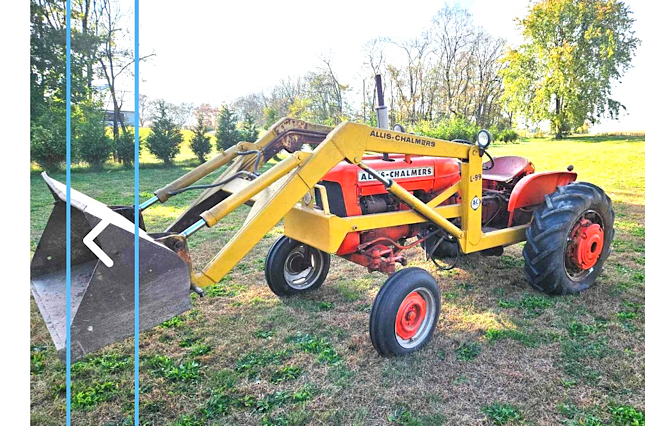

This came through on Auction Zip this morning. Located in Bernville, PA. I don’t know enough to identify the tractor model. The loader reads L-99 Allis Chalmers.

That is a D12. Those front ends and steering boxes are not really ideal for the stress a loader will put on them. However if used conservatively it would beat a shovel. You can see that the front rims are not factory, so they were probably the first causality due to the loader.
 That is actually an industrial loader, not a farm loader. The boom and bucket will extend out further and that also adds to the stress in the front end parts. Generally (except for the earliest) the industrial tractors had Power Steering standard and heavier front axles.

IM with Paul. No way I would put a loader on the D10/D12. The I40, the industrial version of that tractor, used much heavier front end components. That loader in the picture probably came off an I40

I agree with the others, a loader on a 110 or 12 is a death sentance for the steering gear box, and I don't think the worm and sector are available.

X 2... I've had one such steering box rebuilt. They are very feeble to be used on a tractor. Parts for that box are nearly impossible to find. D10/D12 are cute but I wouldn't buy another one as a work horse. For me a D14 is twice the tractor.
