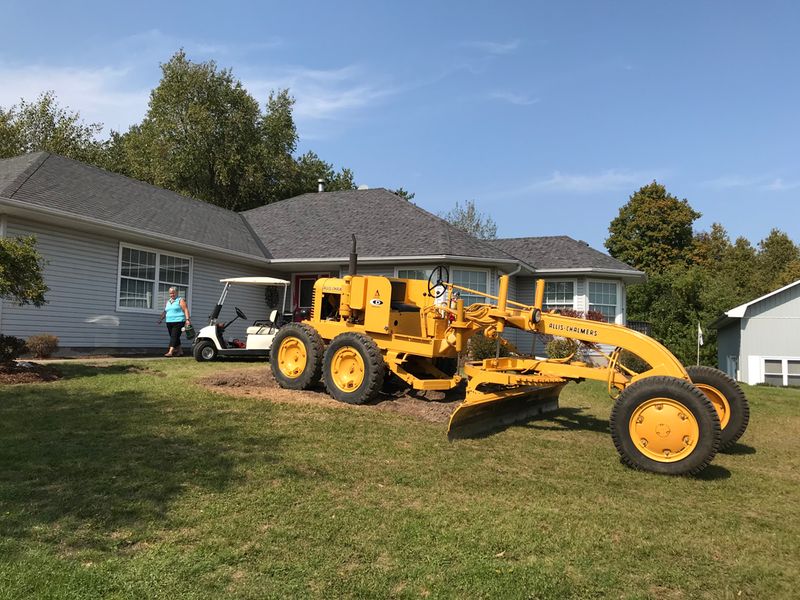

   My 1967 'D Special' with hydraulic brakes, which will be for sale later this week in Ontario, Canada.     Ross D.
