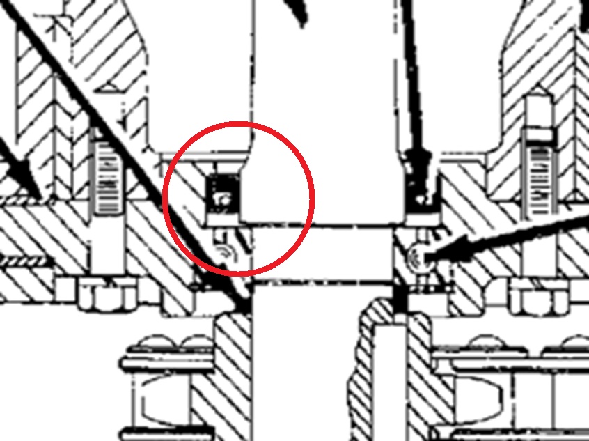

Well, it's been a while since my grader was running and it's finally ready for new hydraulic hoses after replacing all of the spools and adding power steering to it!  But before it's ready to work again, I need to replace the seal on the left rear wheel shaft.  I have a diagram of the assembly from the manual as shown below.
The question is: how to replace the seal?  From what I can see I will need to:
  1. Drain the oil in the chain box
  2. Dismount the rim from the wheel
  3. Remove the wheel (this is going to be seriously hard and probably require an hydraulic puller)
  4. Remove the outer bearing retainer
  5. Remove the old seal
  6. Install the new seal in the retainer
  7. Replace the retainer, probably with a new gasket
  8. Reassemble wheel.
Does that sound right? I expect there's no way to get around pulling the retainer off, but thought it was worth asking the group.

I have never so much as touched a model D grader but looking at the drawing it appears that you are on the right track.
That tapered shaft is probably going to require a serious puller, as you noted above.
It may be possible to use a slide hammer to remove the seal once you get the wheel off, but it may be wise to remove the bearing retainer anyway in order to inspect the bearing as it could be the root cause of the seal leakage.
Best wishes on your project! Smile

look close at the drawing.. It shows the seal installed from the INSIDE and has a lip to keep it from falling OUTWARD toward the wheel....
Hmmm... the arrows in the drawing do tend to obscure things a bit, but it still looks to me like there is a lip to the inside of the seal just above the point of the arrow on the left side. The diagonal lines indicate that portion of the retainer to be contiguous with the main body.

Loosen the nut on the spindle and drive it around in tight circles. This might start to loosen the hub on the taper.

I don’t think you need to remove the sprocket at all. Take the chains apart and the housing should come off around it. Then pull the axle and bearing holder and the seal.

i cant say that i know for sure... but the drawing shows the seal installed from the INSIDE and pushes up aginst a lip in the housing , and keeps it from moving OUTWARD..... look at the lip above the seal...
You are, of course correct Steve Smile
I was looking at the wheel seal which is what I understood the OP to be needing to replace.
