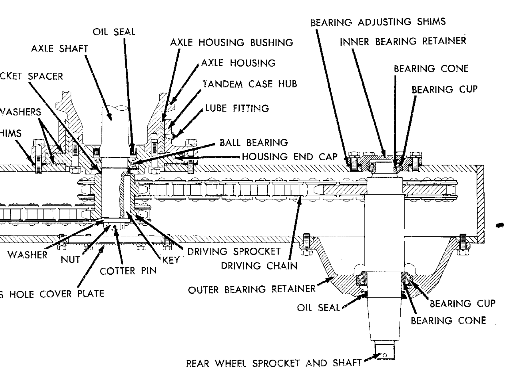

Well, it's been a while since my grader was running and it's finally ready for new hydraulic hoses after replacing all of the spools and adding power steering to it!  But before it's ready to work again, I need to replace the seal on the left rear wheel shaft.  I have a diagram of the assembly from the manual as shown below.
The question is: how to replace the seal?  From what I can see I will need to:
  1. Drain the oil in the chain box
  2. Dismount the rim from the wheel
  3. Remove the wheel (this is going to be seriously hard and probably require an hydraulic puller)
  4. Remove the outer bearing retainer
  5. Remove the old seal
  6. Install the new seal in the retainer
  7. Replace the retainer, probably with a new gasket
  8. Reassemble wheel.
Does that sound right? I expect there's no way to get around pulling the retainer off, but thought it was worth asking the group.

I have never so much as touched a model D grader but looking at the drawing it appears that you are on the right track.
That tapered shaft is probably going to require a serious puller, as you noted above.
It may be possible to use a slide hammer to remove the seal once you get the wheel off, but it may be wise to remove the bearing retainer anyway in order to inspect the bearing as it could be the root cause of the seal leakage.
Best wishes on your project! Smile

look close at the drawing.. It shows the seal installed from the INSIDE and has a lip to keep it from falling OUTWARD toward the wheel....
