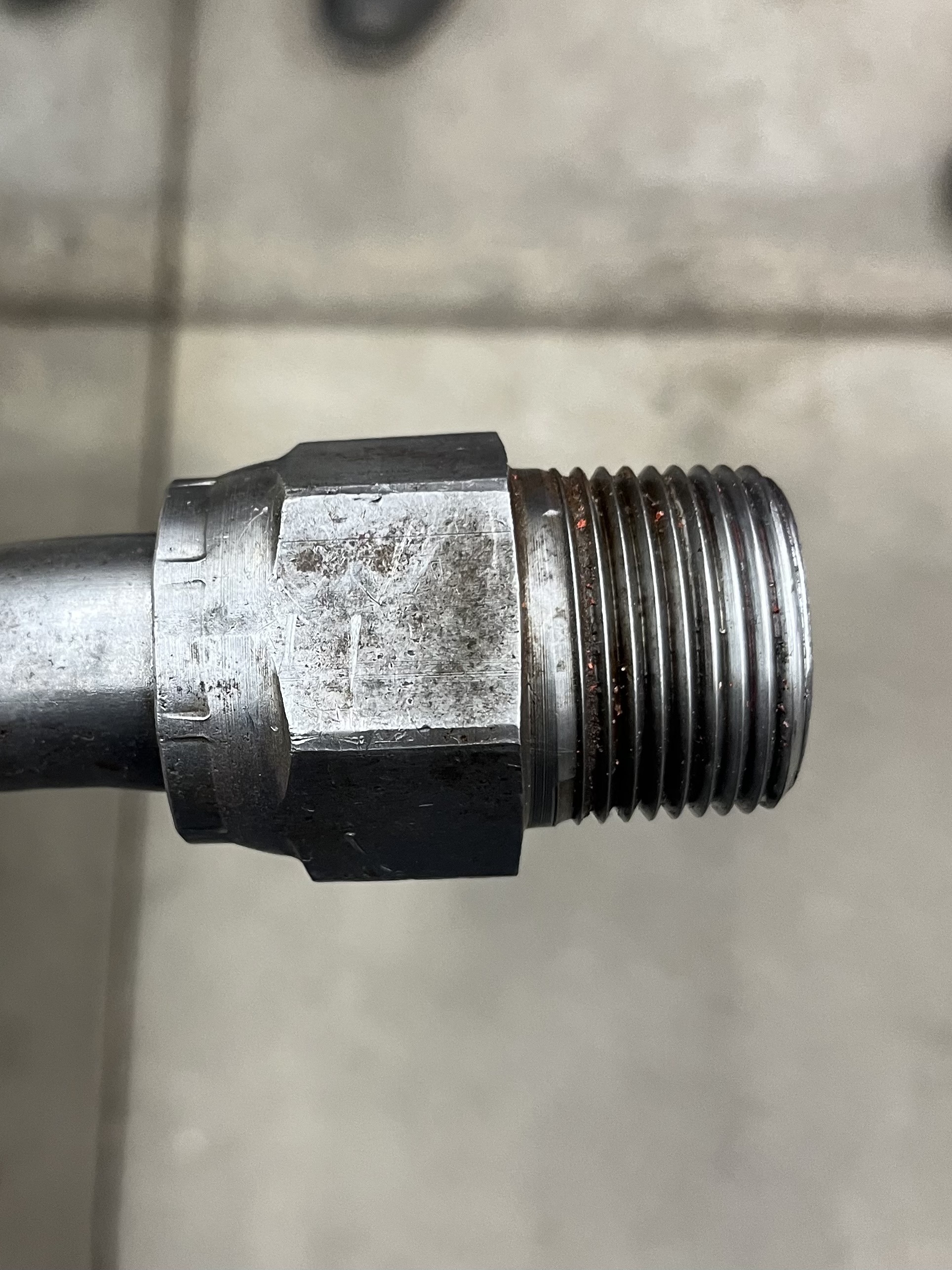

Got the tube off and it is a puzzle the one end is a jic fitting up by the filter housing . The other end that swivels but threads directly into the housing here are the pics any help getting an original or reproduced one would be great

Looks like a male pipe swivel.  Pretty common fitting if it is.  Notorious for leaking after a while though, as they just rely on an internal o-ring to seal.
