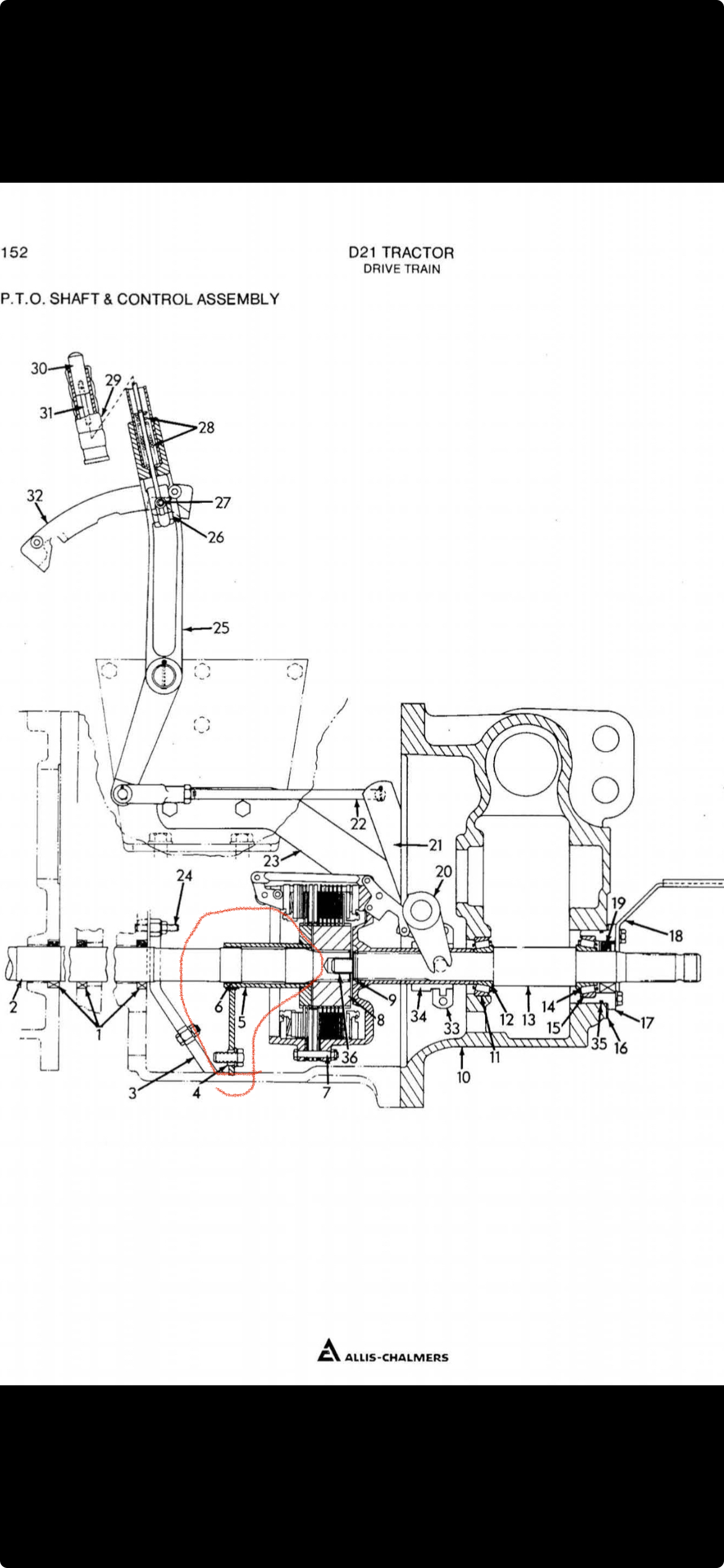

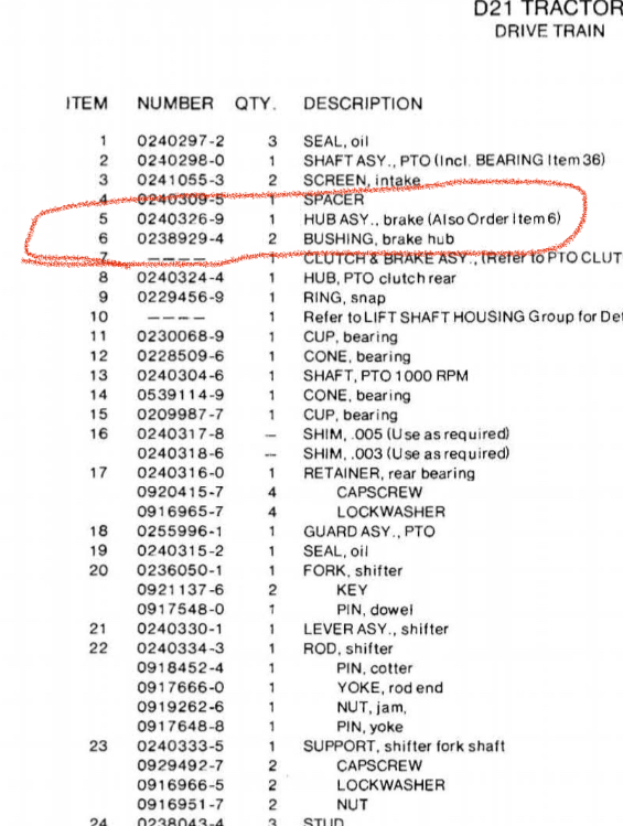

Post Options Post Options   Thanks (0) Thanks(0)   Quote ncpackfan39 Quote  Post ReplyReply Direct Link To This Post Posted: 11 Mar 2024 at 9:07am
Hello,
I’m looking for Allis Chalmers D21 PTO clutch Brake assembly parts. Pictures from the parts manual have the pieces circled that I'm specifically looking for. The parts are the brake assembly parts which are forward of the PTO clutch. If anyone has any of these, feel free to let me know at 919-273-6643. Thanks in advance for any info you might have.

Post Options Post Options   Thanks (0) Thanks(0)   Quote Calvin Schmidt Quote  Post ReplyReply Direct Link To This Post Posted: 15 Mar 2024 at 7:42am
Years ago now, my AC mechanic checked the PTO clutch on my D21. He commented that it was (or looked ) the same as a D series powered director clutch pack. The one side was locked to the main housing to serve as the PTO brake. Can anyone verify this ?
Points: 22319
Post Options Post Options   Thanks (0) Thanks(0)   Quote DrAllis Quote  Post ReplyReply Direct Link To This Post Posted: 15 Mar 2024 at 7:48am
Similar design adapted to the D-21. The differences are the clutch housings depth to accommodate 7 discs on the power side and 2 discs on the brake side. A D-19/175 tractors had 4 discs in high and 5 discs in low for a total of nine driving discs.

Post Options Post Options   Thanks (0) Thanks(0)   Quote ncpackfan39 Quote  Post ReplyReply Direct Link To This Post Posted: 15 Mar 2024 at 10:25am
That is all good info. I appreciate the discussion. The part I’m looking for is the part that attaches to the inside of the rear housing that enable the PTO brake to do its job. I was curious if any other models used the same parts. Thanks for the discussion on that.
