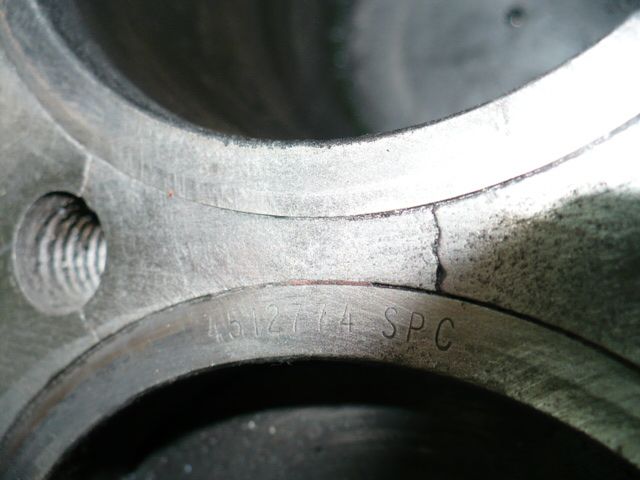

I am looking at a D 19 diesel. The block head bolts holes are warn. The person put a helocoil in a couple.New head gasket. What do I need to watch out for. Cracked head maybe.
 Thanks for the help   Mike

Look out for this along with the treads pulled, dropped sleeves.
