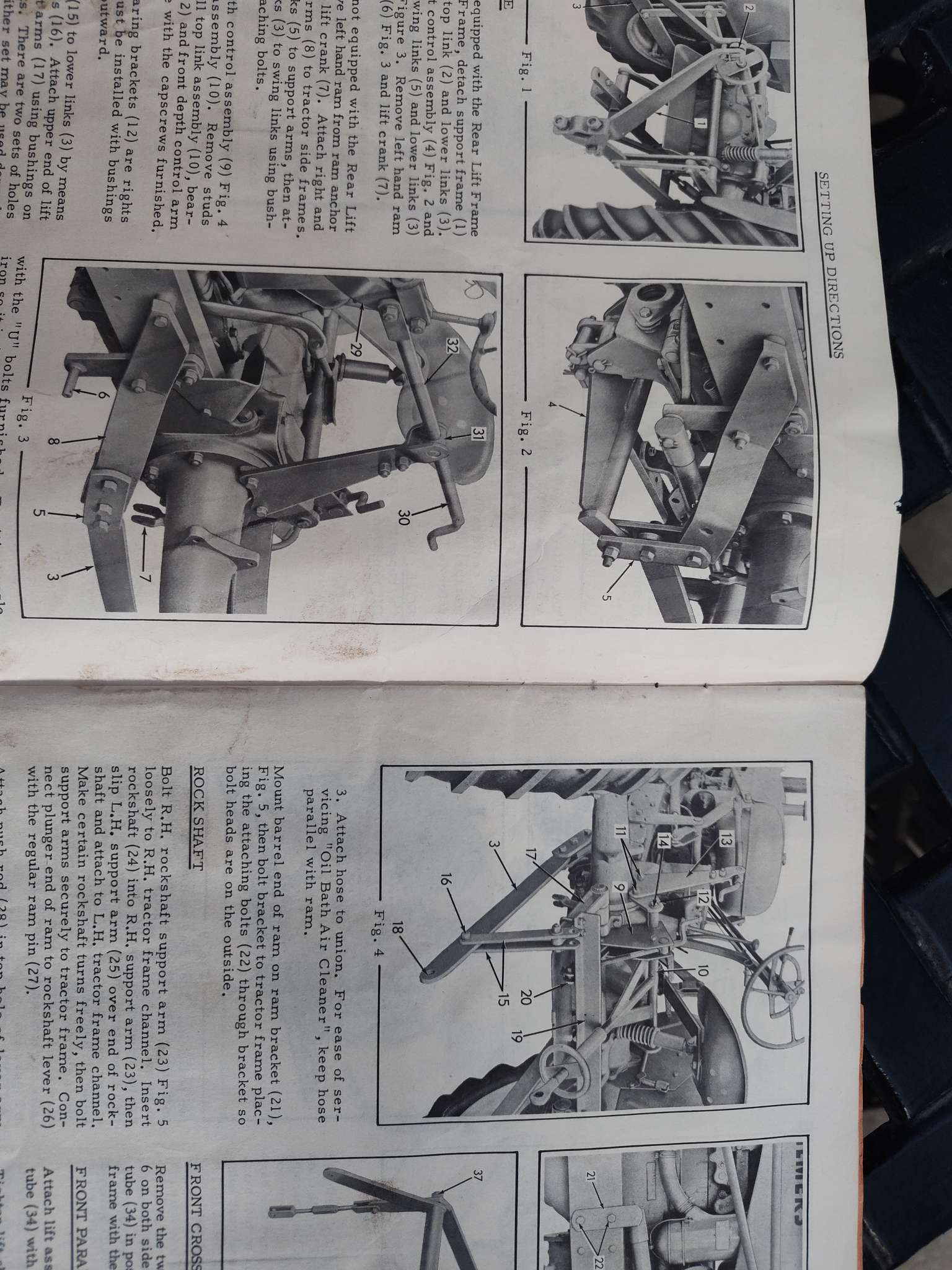

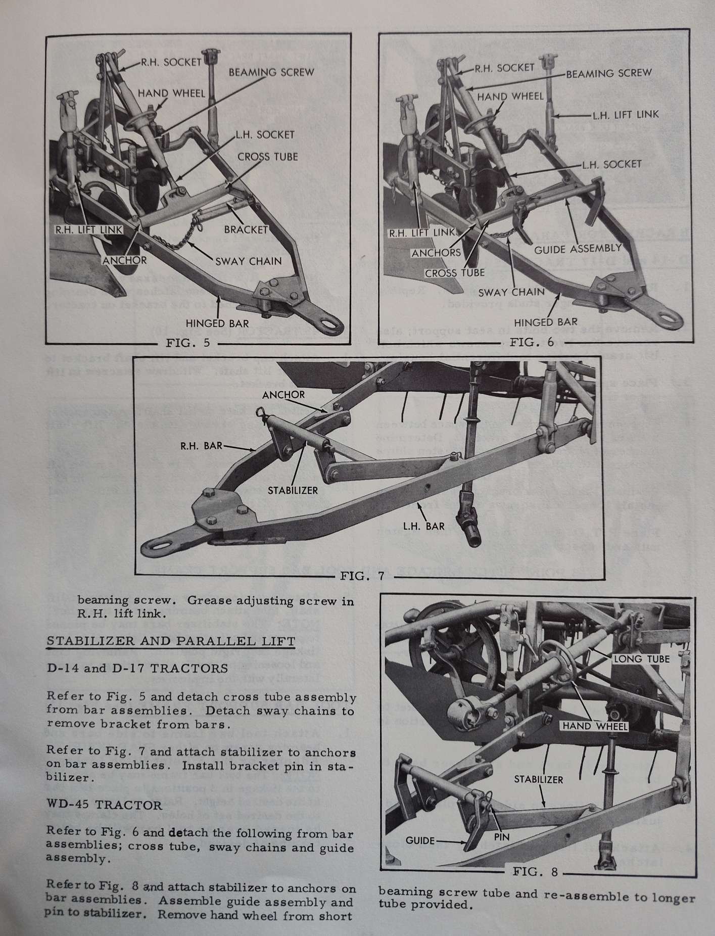

I believe that version allowed operation of traction booster with three point implements. Probably not ideal for a blade. Here are photos from the manual.

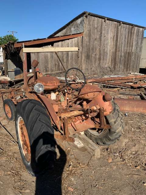

Also a shot of the Oxnard toolbar. This is a very stout 3pt hitch.
It is from the vegetable cultivator manual.
