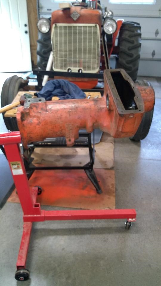

Have the donor final drive on my engine stand . Ran a 3/8-16 tap in the bull gear oil pan holes . Always try to do that and also use new bolts . Crazy how much trash was in the threads . Who knows what's happened over 60 years , I guess . I plan to install the bull gear with new bearings and a seal first while I can rotate it upside down , then I'll do the pinion shaft . I'm hoping that's a good plan . Thanks !

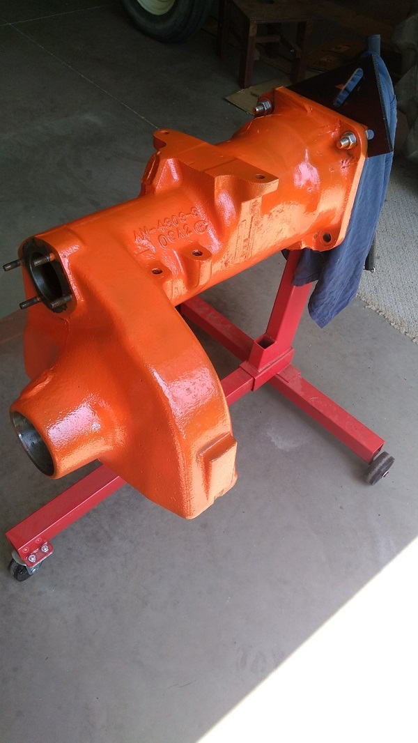

Thanks to my fav son for posting a pic ! While this is on my stand I'm gonna hit it with a little paint . Won't be perfect but it'll look some better . Thanks !

Very nice paint job!! Which paint do you use?

Kinda hate to admit it , but it's just Rust-Oleum Allis Chalmers orange spray paint . Think it's Corporate orange ? THANKS !
