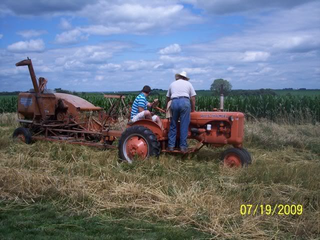

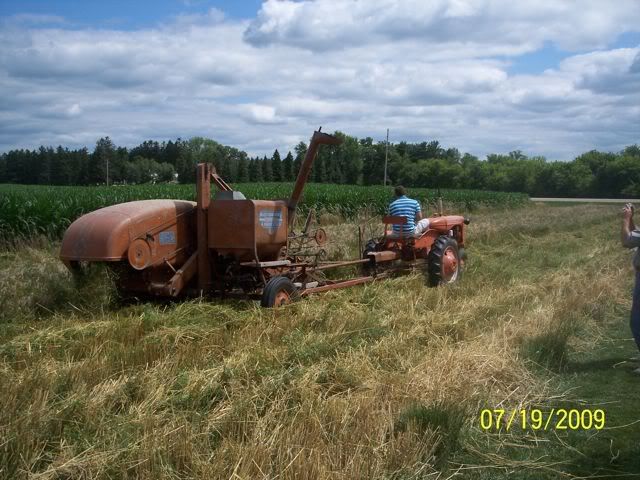

                                       Here are a couple of photos of one of our wheat harvests. This is jim Jrs 40 with the territory rep from KRONE at the controls. There was a lot of kidding about all of the ideas taken from the 40 that will be showing up on krone.lolLOLLOL   Jims 40 did a great job, we had a yard full of onlookers that day, and many pails of wheat taken home for flour.  One year we used the 66 It also did a good job.SmileSmileSmile

   Kelly, that is a beautiful 40 ! Is she all original ?

That is Jim Palmer jr's 40. It was the model for the show toy for the Orange Spectacular.
Jim has a YouTube video of me operating it at Hutch. It is one of my favorites. It sure is a sweet machine!

I believe  that it is.  JimIa can give the whole story on his 40. Its a great running machine. they drove over and went right to work with it. A former neighbor that passed away just a few months ago came to watch it run, his relative had one and he thought that it might be that one. Watching that day he said it brought back many many ac memories. You may have seen him at some time He won many tractor pulls with his d-21, and went to the nationals with it. Deania rembers when he got the first 7040 in the area and took it to a farmers pull and they almost had to drive into town to stop it, The JD men cried.  CryCryCry

   I thought that might be Jim's.

I guess i did not state it clearly in my first  post. It is jim Jrs 40, Jim sr is riding and krone rep is driving.  I do not own a 40. jim and jim are neighbors, That came over to play. I don't have pics of my combines doing it because I'm driving, and am not skilled enough to take pics at the same time.
