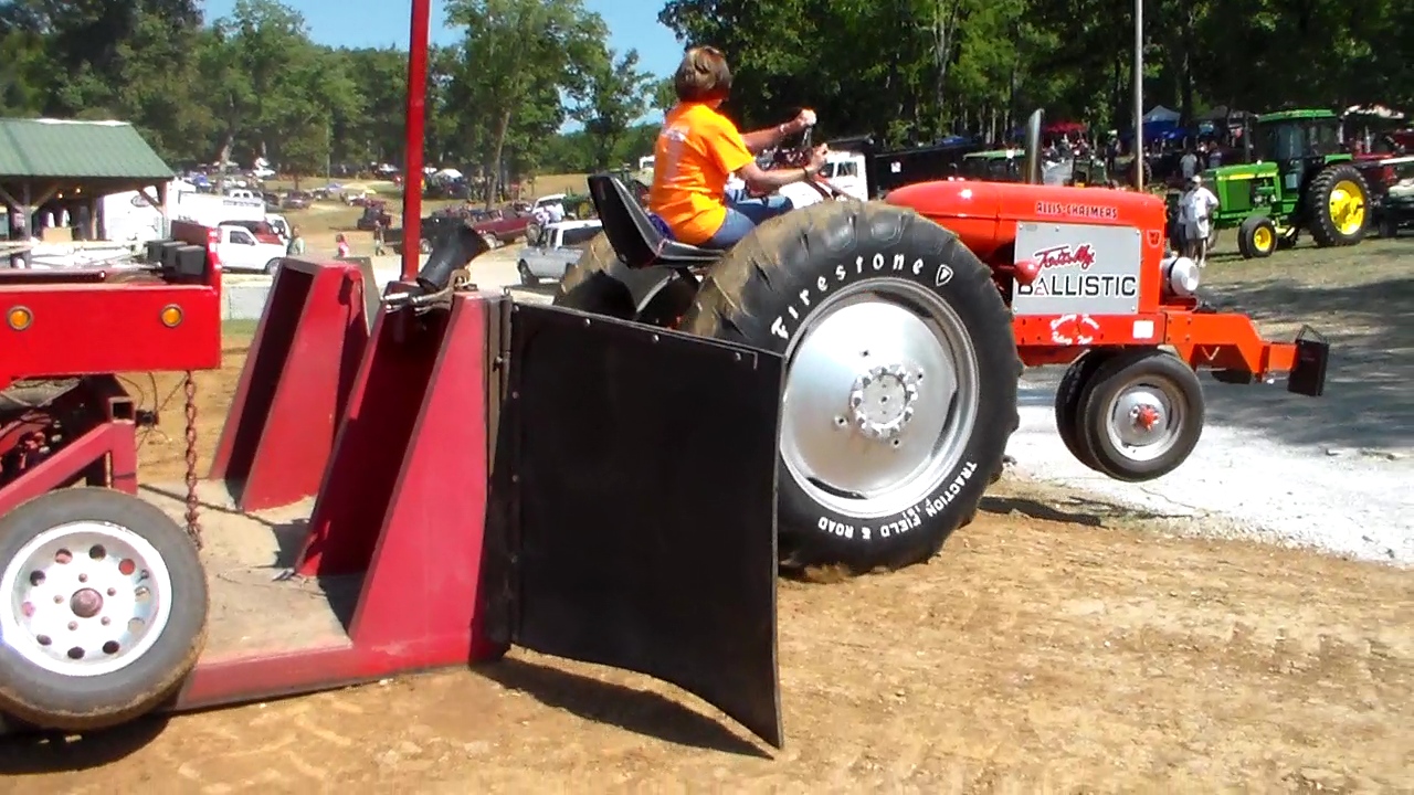

  This is the most recent pic, there is a seat modification, and several other things. Also my jockey driver I have been training, she is doing rather well !

looks like its at the end of track and out of power there when they loose speed from not having the power to maintain speed they all no matter what brand raise the front end . those tractors can get to 2950 lbs no driver. if I was going to change the steering shaft for 12 lbs I would remove the two rear tubes for 30 lbs and a total of 42 lbs removed but that's just me. I should be at east tn pull in nov. awaiting tony, stealth carbs to get my carb done for the A to pull king of the hill class. may see you there. if you go to tunica see if you can look up kent dakin he has one of the light front ends from a massey Ml gave him that tip a few years ago. the easiest way to know if you have the heaviest allis pedestal is when looking down between radiator grill and pedestal if you see daylight. the heavy one protrudes back in under grill . the massey is 100lbs or lighter than the lightest allis pedestal. when you go to Mls for power you loose quiet bit of weight in the block to gain clearance as well.

Man you can tell a lot from a still photo. How do you do it?? I thought they all raised the front wheels a little at the end of the run if they were balanced right. You are one exceptionally observant and smart guy.

No it wasn't a lack of power, it was all kinda funny. Most of the tractors had stopped around 225', she passed the flagman and had done made a 320" pull and was still going. The sled opperator had began to blow the horn. I had always stressed to her to watch the flagman, when he got there he still was holding the green one so she was still going. We finally got her stopped in the gravel! Priceless!

Well I can tell a lot from a still photo.  I'd have to say congrats to the young lady for doing a fine job, the front is in the air and she's still on the throttle, and by the looks of the road (perpindicular to the track) one could make the assumption that she's at the end of the track as the front of the tractor is near the road....get it straight there boys, rear of sled by road= starting line.
You pankey boys need to brighten up a little bit (ok more than a "little").  What did your father have against a proper education anyways.  It seams J and ML are "one in the same".
Now lets amp up the drama a little more.  She's about 100' in front of the competition.  I know some of the naysayers posted above are used to being 100' behind the leaders.....it's been proven on here beforeShocked
Now onto the original question.  The best way to loose weight is to find a light driver!  But you've already done that.  The next best way is to buy a nice set of shiney rims for the back.  We've seen pictures of various hack jobs that look terrable and don't save much weight.  More of an embarasement than anything.  Just loose a load of corn from those record yeilds you're haveing and tell the wife you simply re painted your rims.  If she's like my wife she'll just smile and knod.... I still don't know if she really knows the difference on this stuff or just doesn't want to acknoweldge.
