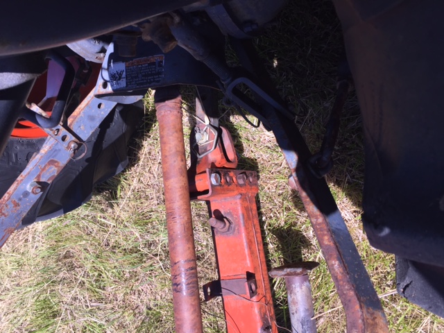

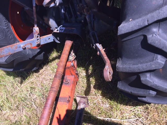

So, I put up more hay this year and never could get a good grasp on turning the tractor with the pull type swather.  Many of you said I could make very tight turns if I went to the left.  I cannot make this work.  But, I also think I now know why.  I think my drawbar is too short.  Where I connect the swather and pin it, is in front of the rear portion of the tires.  As a result, if I make tight turns I end up hitting the tongue of the swather on the rear of the rear tires.  Does this make sense?  Do I need to get a longer draw bar so pin connection is completely behind the tires?  As always, thanks in advance.
See the pics of my current setup.

Whoever decided to put the jack on that side wasn't thinking that's for sure.As for cutting
some thought needs to be put into how the field rakes and bales the best.
Post Options Post Options   Thanks (0) Thanks(0)   Quote shameless dude Quote  Post ReplyReply Direct Link To This Post Posted: 24 Jul 2017 at 4:36am
pull that jack off if you can, if not swing it the other way.

Besides the jack I see a bracket that a center bearing carrier should be to make it two piece pto shaft system. That must make some noise when turning sharp. What's the tractor your using. Have to remember back when these equip were built the tractors where bigger. With same hp as your compact. If your turning to the point that your hitting the tung, I would say its sharp enough.
Points: 55295
Post Options Post Options   Thanks (0) Thanks(0)   Quote DiyDave Quote  Post ReplyReply Direct Link To This Post Posted: 24 Jul 2017 at 7:07pm
If thatsa Kubota pulling the swather, it may have a 2 position drawbar.  Take the drawbar out, and see if it has another hole, that sets the drawbar, further back...Wink

Robinhood, I think that you may be having a terminology misunderstanding here. What you have there are not swing tongues that are designed to be swung back and forth for field operations. However, there are true swing tongues (none made by allis) for cutting hay that you can swing from one side of the tractor to the other for back and forth cutting and always having the tractor in the cut hay. Darrel
Points: 5476
Post Options Post Options   Thanks (0) Thanks(0)   Quote AC720Man Quote  Post ReplyReply Direct Link To This Post Posted: 24 Jul 2017 at 8:06pm
Tbone, Dave, and others on here are correct. Extending the drawbar away from the tractor will be a big help as well as moving the jack to the left side and positioning back farther. With practice you will be able to come to the end of a field, turn right with a little right brake sharp enough not hit the tongue of the equipment, and as someone said when you straighten back out to go across the field it should back up and start cutting again across the end of the field without stopping. Dad's AC 390 haybine does this well. If I could get the video on here you could see my 190XT and dad's 390 haybine in action, you would understand after seeing it done.

As always, many thanks for all the comments.  So for clarification, I'm leaving the swather and baler  in the operation mode (not travel position) and leaving it there.  I'm not swinging it back and forth.
Also, I am pulling it with a Kubota and when I turn, the rear tires do hit the tongue.  I will look at the tractor and see if the draw bar has two positions.  I hope it does as I think this will solve many problems.  At the end of the video, it is obvious that the pin connection is clearly behind the rear tires.

Another thing you can try is to use a 3 point hitch drawbar, between the lift arms, to pull the swather.  I don't recommend it on hills, but in flat areas, it should work fine...

For standard 540 pto operation the drawbar hole is supposed to be 14 inches behind the pto shaft coming out of the tractor. It looks closer than that on the picture. Moving the drawbar back will help you to turn shorter.
