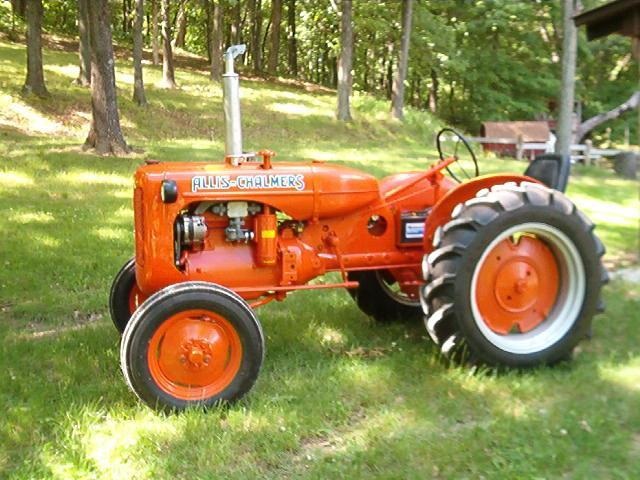

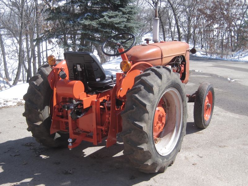

This is more or less what it looks like now:
Have done a little more painting on it since this photo was taken, and have been working on getting it to run a little better.  Took it out to the woods to document finally getting it running.  Had to have the carburetor off another 2 times after to finally get it to run without choke.  Also adjusted the timing a little at the distributor, but still not running quite right.
Have it stripped down to paint the back half right now.  Will have a go at leak at the front crank seal before too long here.

Love it! Low rider B model. I think the Model B is one model Tractor that has gone through more changes whether custom or revised than any other AC Tractor. I'm a hotrodder by heart so I always do something with my Tractors a little different than stock. I've been collectiing parts for my other B for a few years to build a low rider. Pretty cool Tractor. Thanks for sharing. Welcome to the Orange family!

Thats a good looking little tractor.. You have had it a week so i assume MOST of the MODS were there when you bought it ?
The steering wheel / shaft is not the original setup. The tube is several inches shorter and has been mounted to a plate and angled more vertical... which makes it a better setup when you move the seat forward, and rotate the rear axles forward.... I assume you know the rear axles were originally mounted  vertical with the oil pan on the bottom.. you can rotate them forward 90 degrees and that lowers the tractor 7 inches.. That was done on the IB tractors.
Rear hubs are deep dish. Almost look like a "C" rear hubs, with the 5 bolt pattern... Most of the "B" were splined to the shaft.. some had the 5 bolt, but not that deep of dish... maybe even the entire rear end is from a C ?..... not close enough to see from here.   Wishbone front end would have made it set kind of HIGH on the front ??

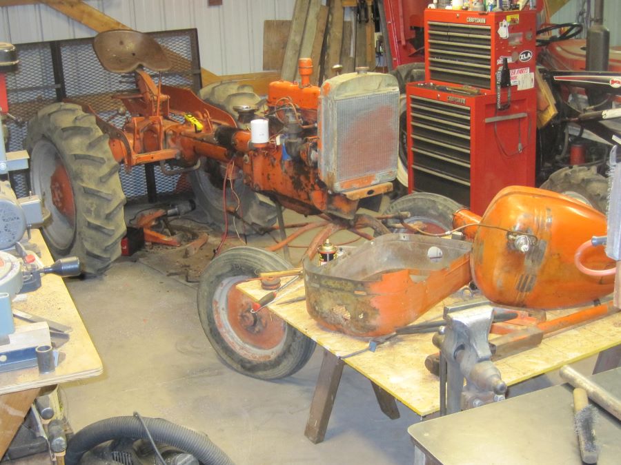

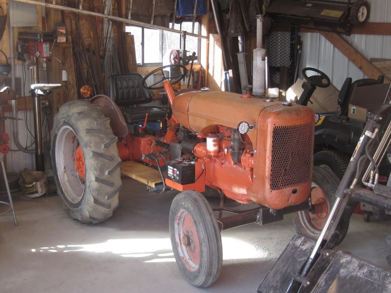

No, actually bought it back in August in it's original configuration.  Here's an early picture.
Replaced bearings and seals in rear final drive after welding up rust-through in the pan.  Replaced spacer in the transmission and refreshed seals in the transmission and left final as well.  Lowered it in the process of those fixes and then started fabbing the front axle, gas tank support, platform, hitch, fender supports, seat supports, etc.  Have removed the PTO, original hydraulics and belt pulley drive to have my own custom hydraulics.
Just installed the hydraulic pump today on that boss in my rear block-out plate.  Have a little more painting to do, but will have to wait for the coat that is on there now to dry.  It's pretty cold here in Wisconsin this week, so will be working on other things while I wait for that.

OK... that explains a LOT.. YOU have done all the work... Some how i read that you got it last week ??  Does that sound like last AUGUST ??  Wink
Did you eliminate the hydraulic pump / pto shaft and build the new cover.. or was that the way it came ?
Still think the wheels ( deep dish) are off a C ... hard to tell about the final drive WIDTH from the photos... Could have been a B with 5 bolt axles..

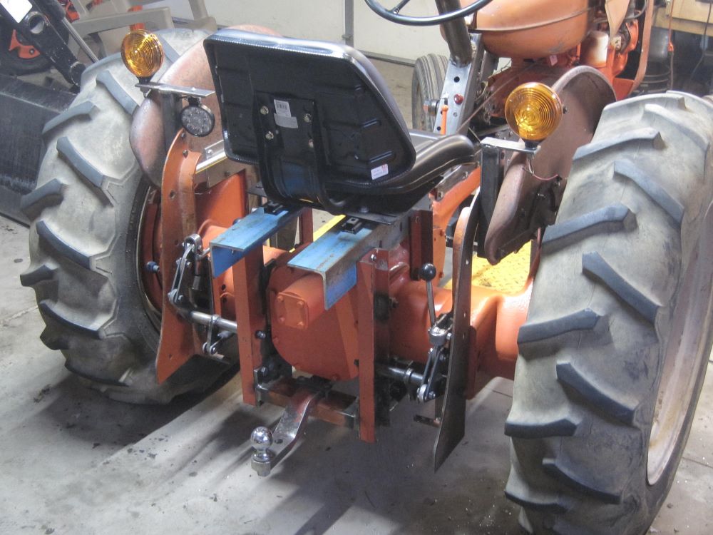

Lots of DESIGN and FIGURIN on that rear brake setup ! Does it have a brake pedal also.. or just the two hand levers ?

Yes the rear wheels are deep dish that match a C.   Don't have a lot of experience with Allis, so just figure the 5-bolt rears for a B were the same as C?  I bought the inner weights off a C from a salvage guy and have cleaned up, painted, and mounted on there, so definitely are the C-style wheels.
Yes, have custom clutch and brake pedals.  Those are just the brake locks in the picture, but they work in place of the pedals as well.
Yes, took the original rear cover w/ PTO, hydraulics, and belt pulley off and replaced with my own cover.  Original had lots of leaks and needed adjustment (bearings?).  I could have made that work for hydraulics, I guess.  Just figured I didn't need the extra aggravation of chasing those leaks.  I'm planning to leave this tractor hooked to my hydraulic dump trailer, so wouldn't have use for PTO or belt.  Have a couple other tractors for those other jobs, anyway.

that will be about 1000 times easyer to get on and off of .   nice fabricating

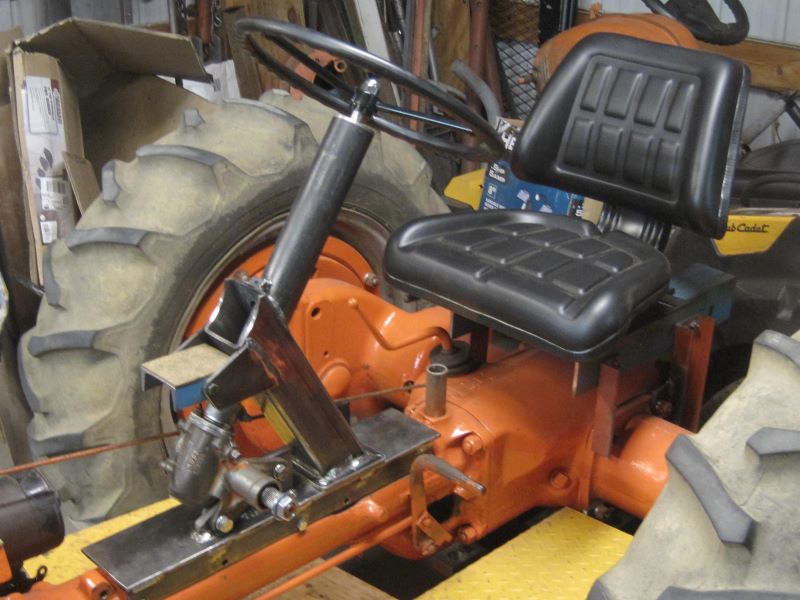

Is that the factory steering column and gear box... just cut  a foot of the length ?  Where did you hide the battery ?

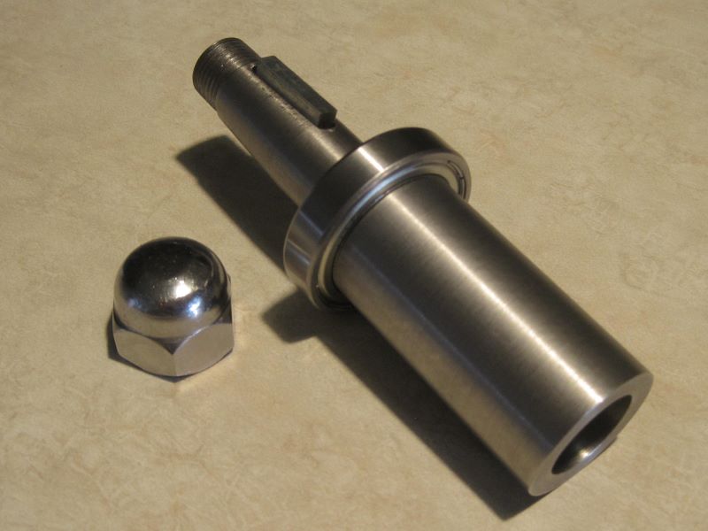

Yes, shortened the original steering shaft and made a new top for it.  It is quite a lot shorter than stock.  You can see the gas tank mount there as well.
The original steering tube just fits inside of the new steering column.  I know it's a little overbuilt, but at the time was still sorting out what I was going to do for a throttle, and thought I might possibly mount it, or possibly other things as well, on there.
I just cut the original shaft off and welded this bit on top.  That ball bearing is slip fit inside of the steering column from the bottom.  Have had it on and off several times now in the course of rebuilding the steering box, doing the electrical, etc.

Good idea on the steering shaft.. I lowered a B several years ago and cut 8 inches off the steering shaft, but kept the original mount.... moving it BACK and tilting it UP looks like a good idea....
In fact, i normally cut 6 inches off ALL of the steering shafts on the B and gives me more room to get ON and OFF ... and i dont like the steering wheel stuck in my chest..

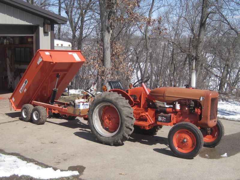

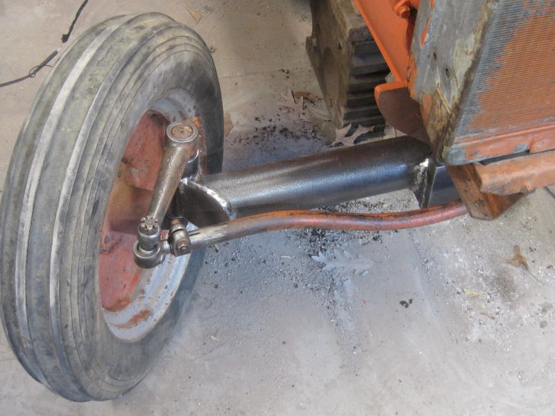

Here is a B that i rotated the finals and built a straight front axle. I cut several inches off the steering tube, but still uses the original mounts.. YES, there is room for the battery in the original location on this one...... Photo says 2004 for a date... DANG !! Didnt realize it had been 20 years !   ... i have a belly mower on it now.. we call it the "Orchard B "..
Jim2 View Drop Down

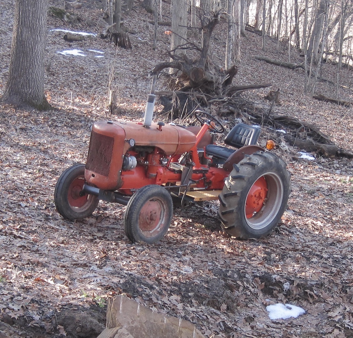

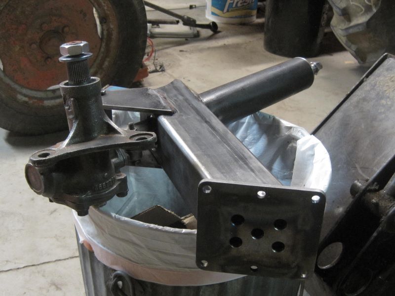

Don't think that I mentioned it earlier, but I also reduced the wheelbase when I lowered the tractor.  Here's an in-process picture from when I was working on it and before adding rear bracing.
I know the picture isn't the best, but you can kind of see that the axle is mounted behind the pivot point.  The kingpins are also centered on the rear of the axle.  That shortened the wheelbase by about 4 1/2".  I think I'm at maybe just a little over 60" now.
Was just playing around with having the tie-rod in front of the axle at the time.  Decided that didn't work very well, and have since moved it back behind the axle.
