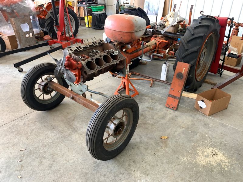

Sharing my current project. Some time ago I asked if anyone had ever installed a small block in an Allis B. No one responded. I inherited this low rider project from a fellow club member who passed away. His plan was to use a B engine. I changed gears, and am adapting a small block instead.
Thought I would share my progress so far. Completion will happen some time in 2025, due to spending 5 months in Florida this coming Winter. Comments and suggestions are welcome.

So far on the Low Rider B project, I had a laser cut adapter plate to mate the engine to the B  bell housing.  Then I used a Chevrolet standard shift flywheel cut down to the B size flywheel and drilled and tapped to accept the B  pressure plate.  In order to make the starter and clutch work I had a coupling made to attach the small block crank shaft to the chevrolet flywheel.  That moved the flywheel back far enough so the starter and clutch would work properly.  Currently concentrating on the front of the engine building brackets to mount the front axle and maintain the correct height so the radiator and front radiator housing will stay at the same height as the gas tank.  The gauge panel will be housed in the hood like a WD45 Diesel

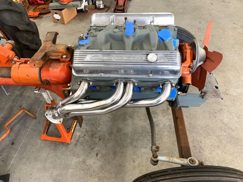

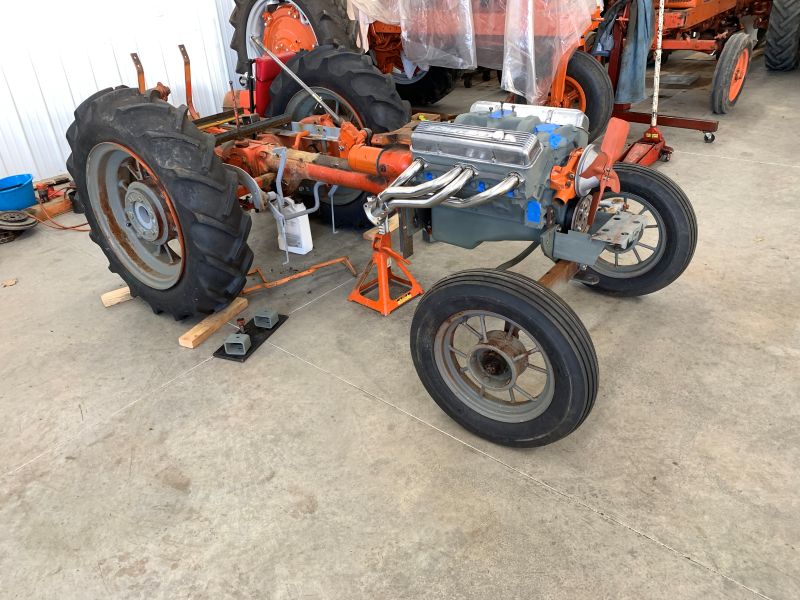

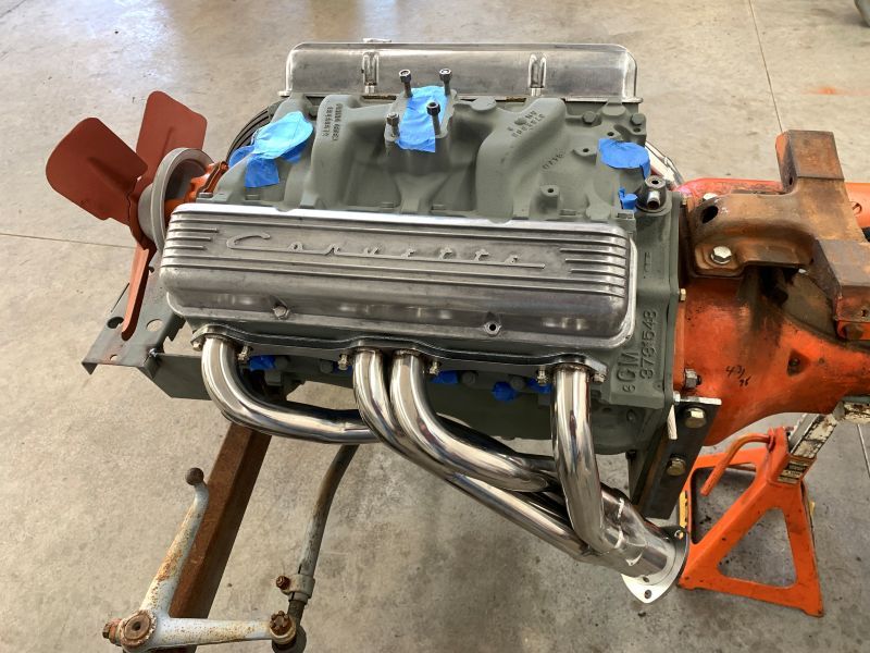

Posting an updated progress report.  Mock up engine has been removed, and a completely rebuilt " 283" engine has been installed.  Cut down Chevrolet flywheel with a B ring gear was used.  A 2 and 3/8 inch spacer installed between the crankshaft and the flywheel.  That makes the B flywheel work with the ALLIS starter.    The B clutch disc and pressure plate were also used.  Modifications to the B radiator, fuel tank and extended hood are underway.  Stabilizers for the front axle are also being fabricated.  Steering arm is still an unknown issue.  Haven't got to that yet. Any suggestions?

Post Options Post Options   Thanks (0) Thanks(0)   Quote Straanger Quote  Post ReplyReply Direct Link To This Post Posted: 16 Nov 2024 at 12:33pm
Maybe use upswept headers. Have room for a drag link then.
Besides, tractor exhaust is supposed to go up!
plummerscarin View Drop Down
Joined: 22 Jun 2015
Location: ia
Points: 4169
Post Options Post Options   Thanks (0) Thanks(0)   Quote plummerscarin Quote  Post ReplyReply Direct Link To This Post Posted: 16 Nov 2024 at 6:21pm
Low exhaust for orchard use
Points: 12071
Post Options Post Options   Thanks (0) Thanks(0)   Quote Steve in NJ Quote  Post ReplyReply Direct Link To This Post Posted: 16 Nov 2024 at 11:02pm
If I didn't know better, I'd say they look like Chevy Pickup headers. They look great! Stainless too!
