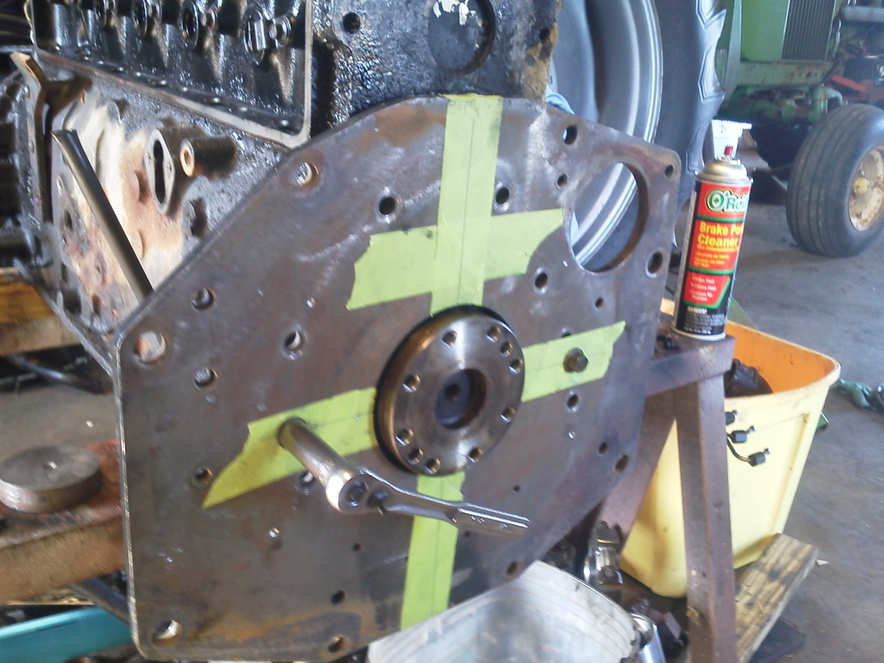

Gettin it to mate up to the adapter plate has been a bear!!! That input shaft has to line up perfectly, then get all the holes to go together....

Did you bore the adpator plate or the Cummins seal or is seal behind plate?    MACK

Tractor model Cummins engine will be installed and and size of engine.

Back plate so far set at 1/2 inch from block to get it to be spaced right for the pilot bearing. The original seal is used,  going to cut out that section on the plate so it will clear. Using a sfi cummins steel flywheel turned down to fit 7000 ring gear. starter will have to be spaced away from plate to contact ring gear, because a cummins crank protrudes 1 1/2 inch out of block, allis is flush. This is a 5.9 going into a 7000 chassis for a puller. hate to change it but bought a complete motor for the same price to get 301 rods hardend. As far as I know a 5.9 has never been instaled in a 301 tractor except the 7010 and 20.

Need a starter spacer if anyone has one, they were used on power units with twinn disc clutches.

I had a plate made to put a 5.9 in a 180. Its is 1" thick and used a 6 speed dodge flywheel cut down to the 180's ring gear.
But this is as far as i got.
