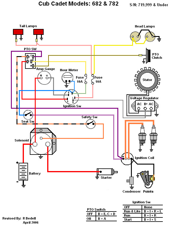

this might help with the trouble shooting.....
'borrowed' from ... https://www.onlycubcadets.net/forum/showthread.php?t=21https://www.onlycubcadets.net/forum/showthread.php?t=21

Post Options Post Options   Thanks (0) Thanks(0)   Quote jaybmiller Quote  Post ReplyReply Direct Link To This Post Posted: 27 May 2020 at 11:33am
Always happy to help. If yours has a higher serial number, that website has another wiring diagram....
