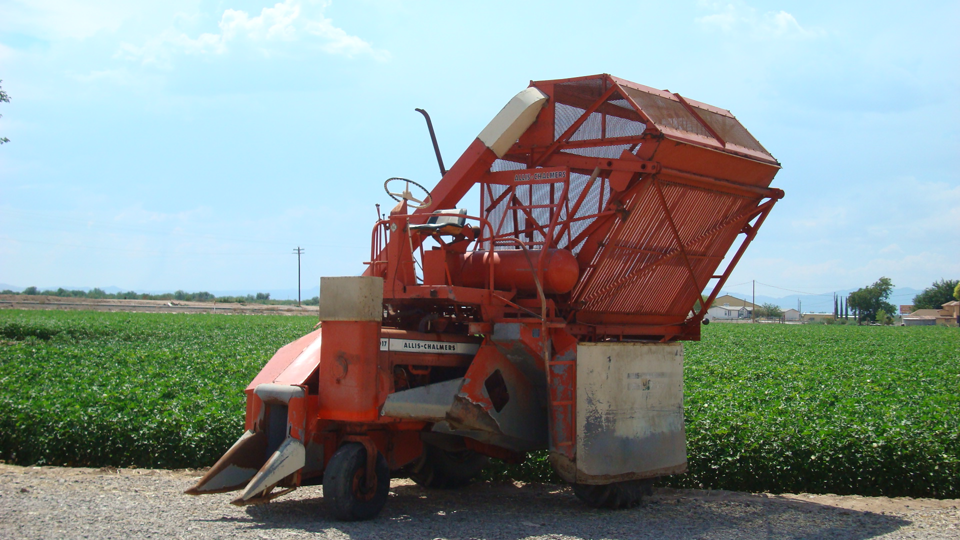

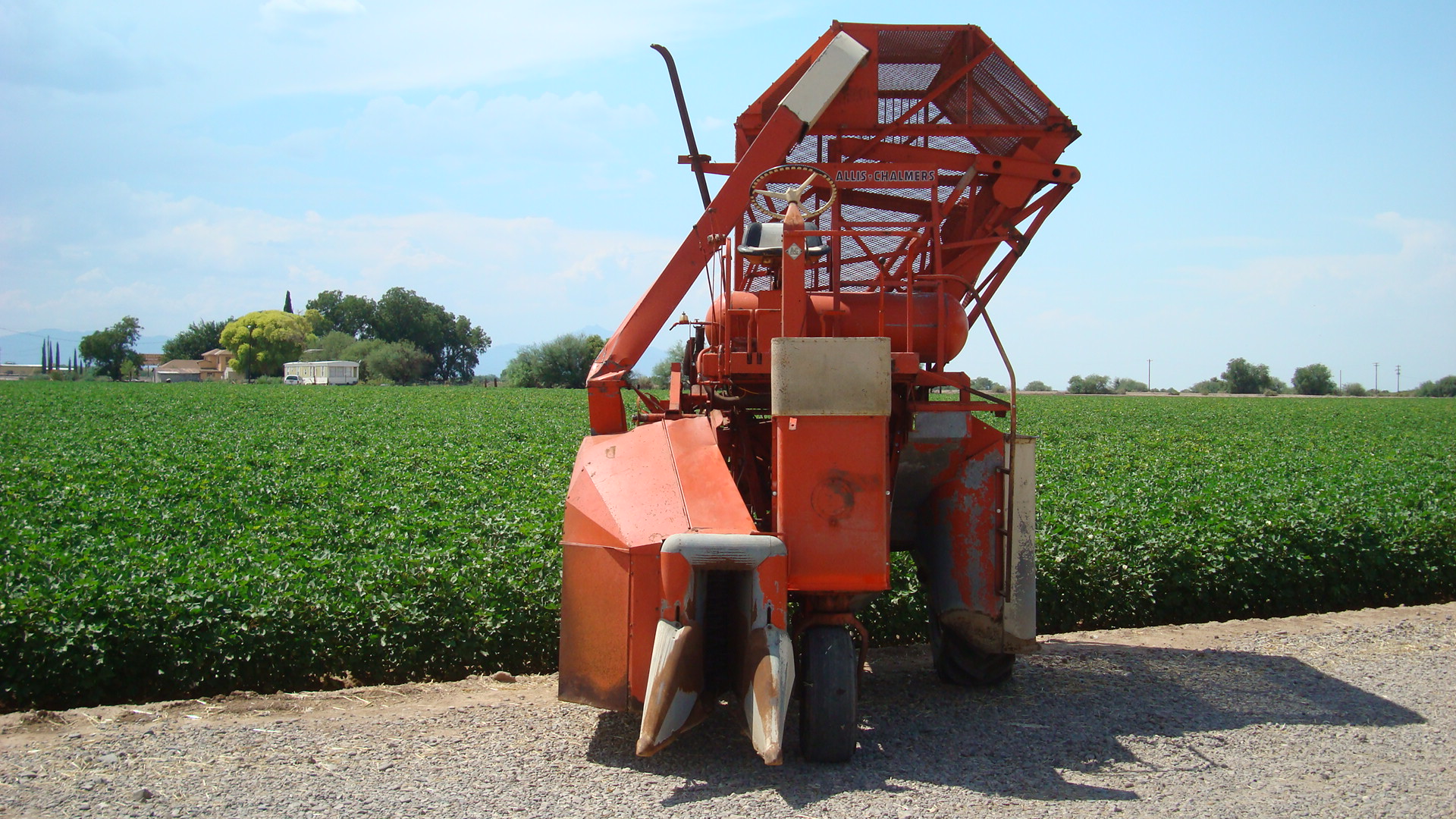

Got the 116 picker home and got it mounted on the D17.  Thanks Henry!

Wow! What a project! I have not ever seen anything like that. Looks like a  job well done. Lets see some pictures of some of your other treasures..  Dave.

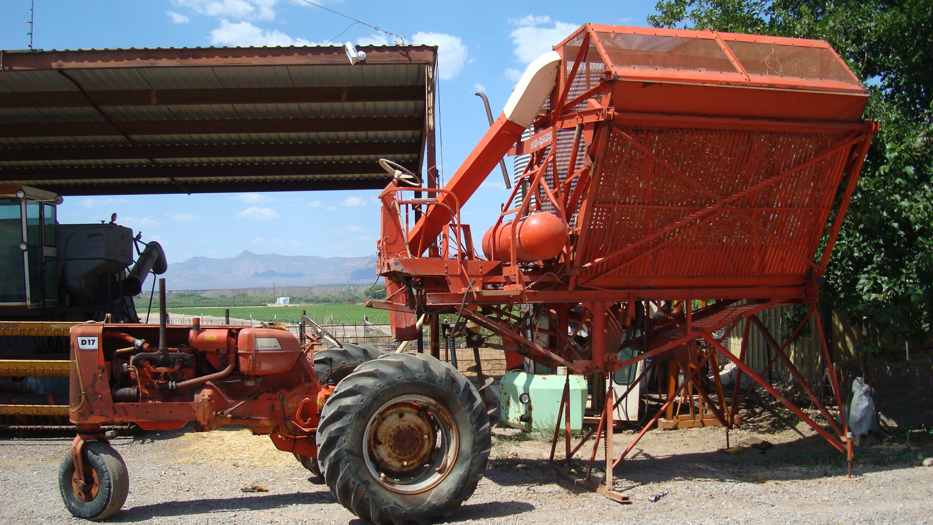

How do the controls work? Electrical ,clutch,steering,shifting???

That's a great find!! I think there are not very many of that model.Most of the pickers you see are the 616's where the tractor is reversed under the picker.

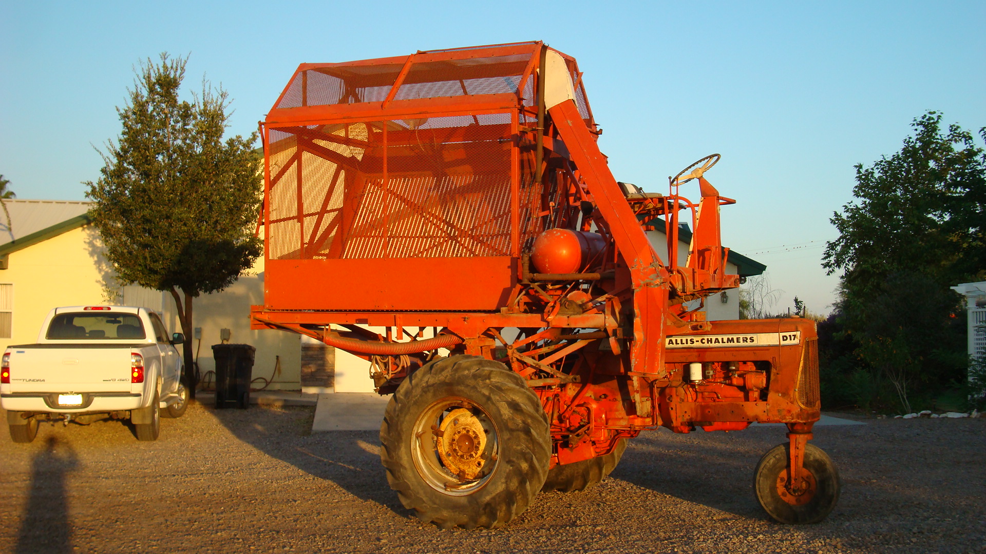

I've parted out a 616 to get the tractor out from under it before. I also know where there is another 616 if it hasn't been sent to china yet. Fascinating how they were integrated onto the tractor base.

My first thought was -- theres a tractor under there? ? Oh there it is !!

boy, that must be fun to mount.  and I agree with the top heavy comment.  very interesting to see.

Thanks so much for the pictures!Looks like the d-17 is hiding! Take more pics if you can, when its in the field takin cotton off, as you can guess us northern boys have not seen a cotton picker in action up here! Lol
The clutch and brakes are worked with hydraulic master/slave setups similar to what you see in automotive applications.  The slave cylinder for the clutch mounts on the floor plate and the brake slaves mount to a bracket that bolts to the transmission just beneath the floor plate.
The electrical has a pigtail that slips under the hood on the right side and has eyelets that bolt into the tractor's main harness around the battery & starter relay area.  It even has the same color and gauges as the tractor which made it easy to see where each one went.
The steering has a chain drive that is turned by the wheel on the picker that in turn drives a universal shaft that bolts onto the tractor's steering wheel using a triangle shaped plate.
The transmission is shifted with a rod linkage assembly.  Its interesting to shift, the shift pattern is upside down and backwards!
All the other controls pto, range, throttle ect are all done through rod linkage as well.

We hope to do a little playing in the field with it one of these days.  There's still somemore work to get her ready for the field.  The head unit is currently stuck most likely due to sitting on the ground and rusting up the bottom drive chain.  It will sure be neat to see it working.

Way cool!!! what is the tank for behind the pickers operator platform? And i used to think it was a pain to mount the two row picker on dads D 17
