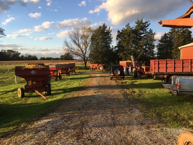

Got the club corn done the other day, --have 14 rows of my own here to do---planted late, not dry enough yet to keep in wagon til used.

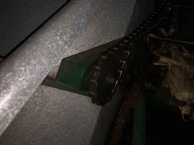

Originally posted by clarkscreek clarkscreek wrote:
What is the stalk kit and what does it consist of?
   This is a set of paddles that helps pull out stalks and feeds to trash rollers that get through the snapping rolls and installed in 1st elevator, sold as an option kit. Helps to minimize what trash gets fed though husking bed. I can take a picture when I get out to the farm if you would like. Kevin

That would be great. I think I may have seen what your talking about on the two row pickers but haven't seen that on the one row before.

This is another picture of the assembly from the outside.
