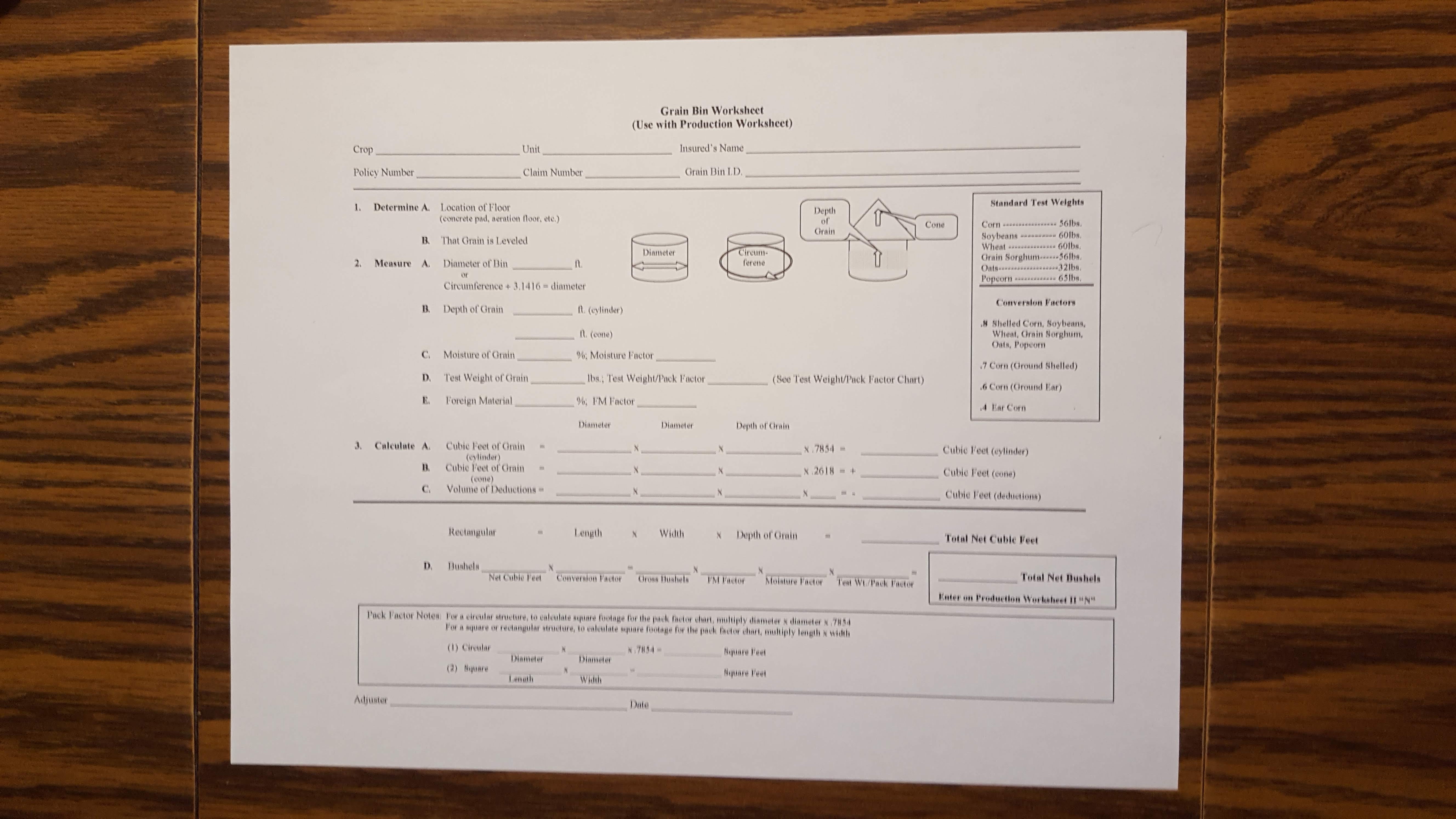

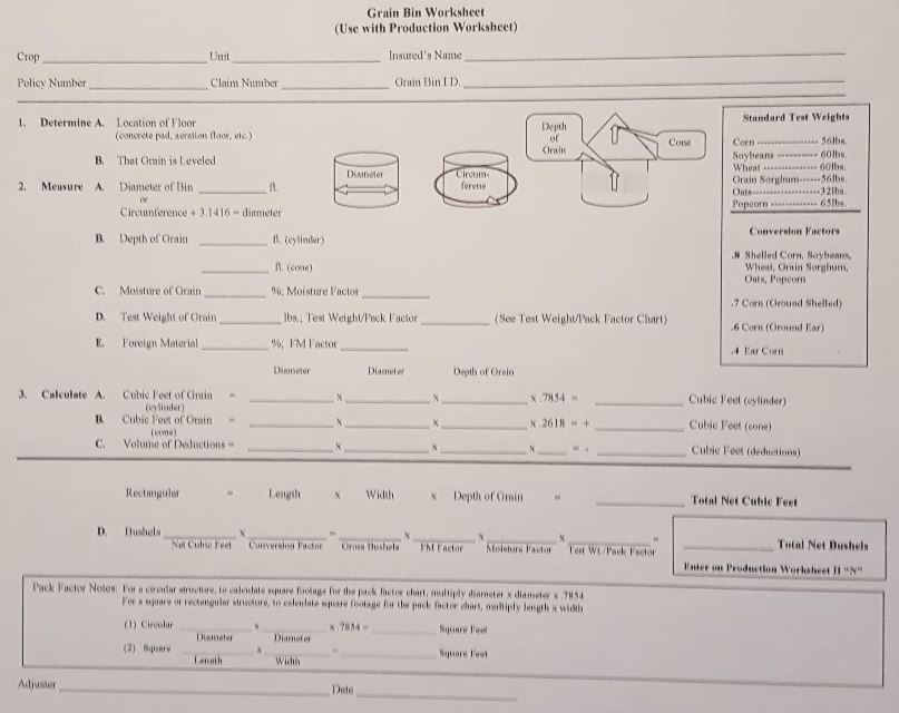

Here is a Grain Bin Worksheet. You still need the Test Weight, Moisture and Pack Factors. These are what is established by USDA. Elevators use their own moisture and test weight factors that you see on your load ticket and settlement sheet.

Hot Link the original workable web page.
This may help.
The Grain Bin/Bushel Calculator can easily be used to determine the number of bushels being stored in a bin.  You will need to know: circumference (if bin is round), length and width (if bin is rectangular), grain height, grain peak height and actual test weight of the commodity.
