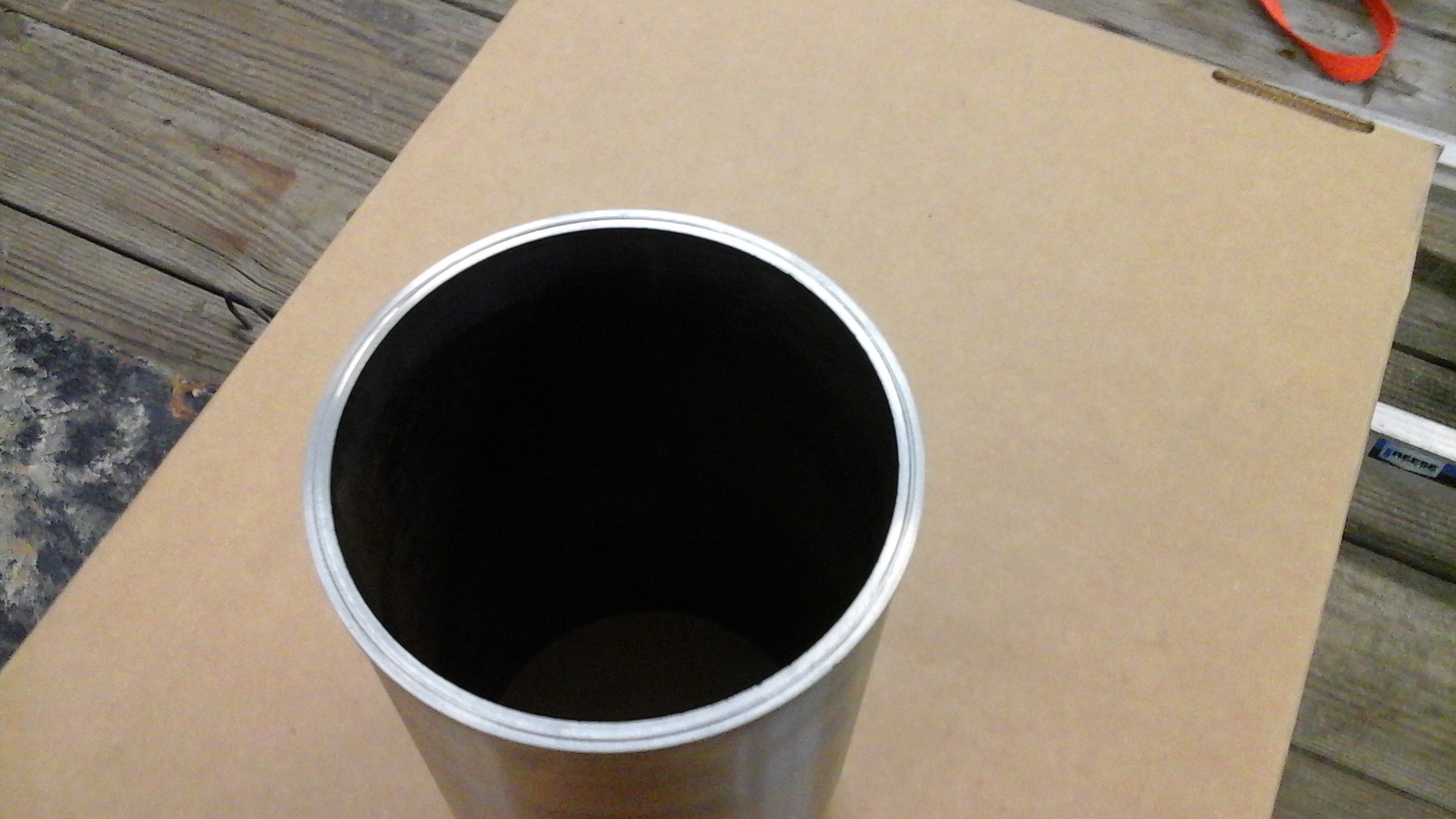

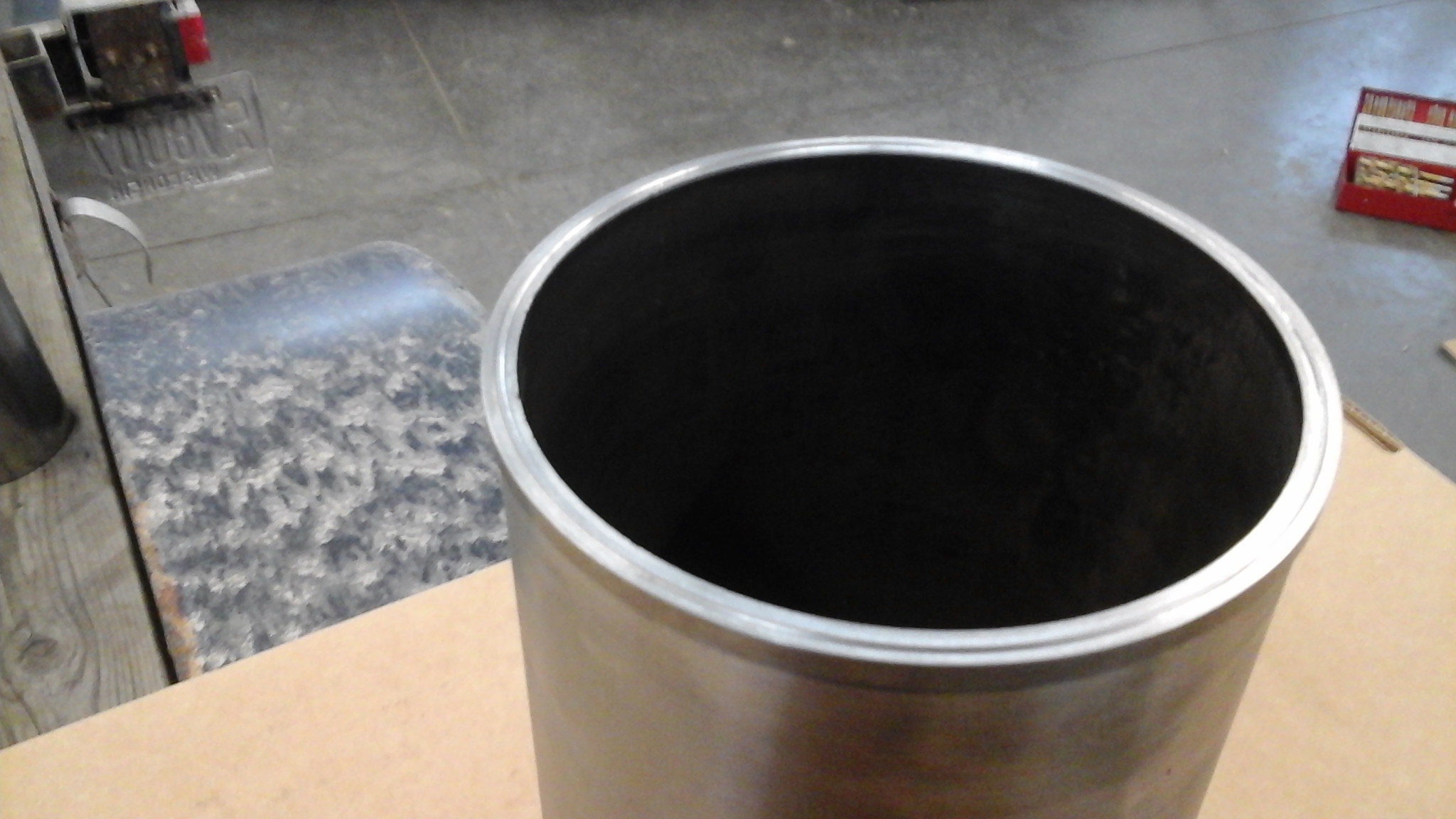

Post Options Post Options   Thanks (0) Thanks(0)   Quote Robacpuller Quote  Post ReplyReply Direct Link To This Post Posted: 05 Feb 2022 at 7:39pm
Defiantlyput o ring on sleave, I make my sleaves with o-ring.
Robacpuller View Drop Down
Joined: 07 Apr 2016
Location: Wisconsin
Points: 248
Post Options Post Options   Thanks (0) Thanks(0)   Quote Robacpuller Quote  Post ReplyReply Direct Link To This Post Posted: 05 Feb 2022 at 7:40pm
I TURN o ring right on top. .015
