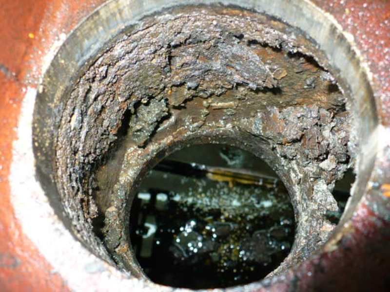

I hope your engine is not looking this this one inside.

Back in the working days of the older tractors if they needed coolant added most farmers just stopped at the pond, creek or water hole in a low place and dipped water out and poured it in and back to work.If you look at the pics I posted before think about breaking that crap lush and it moving into the radiator, water pump and plugging them up.

Holy smokes Don! That almost looks like what my engine looked like, except it was packed tighter!  LOL!  Yuk!! That's nasty stuff right dare....!
You are spot on Steve, It cleaned right out after I got the old steam cleaner in there, just to find all the cracks inside the block.Ouch
