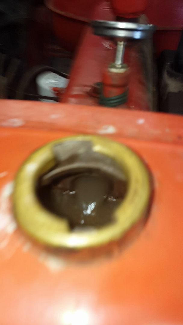

So having problems with my C overheating get slowly at a fast idle in the garage. I have drained the coolant and fillEd and drained with water 2 times and now have water and a bottle of peak flush in it. Still getting alot of craplaces out of it. Especially the small shiny specs of metal from bars leak....
I noticed though with the peacock open on the radiator I can pour a gallon of water in the top and it bubbles and gurgle then slowly comes out the bottom. Should it just ruse right through it? If it's plugged can i ret putting in sk.e water followed by a blast of air from the compressor to try and free the blockage? How much psi would you use? |

OK so was doing a few crude tests to try and rule out what I can. This morning I started it up and let it run for about 5 minutes I was watching the coolant come out of the thermostat housing through the radiator cap hole. It seemed to have a somewhat decent flow right after starting while cold but after a few minutes of running once the temperature got around 120 degrees or so it almost looked like the floor started slowing down a little bit. Then I shut it off waited a few minutes and place my hand all over the radiator to see if there was any cool spots and warm spots. The radiator seems to be a uniform temperature all across the fence with only the very top and bottom part of the tank being warmer than the rest so that leads me to believe that the radiator must be flowing the coolant through it fast enough for the rate the water pump is pumping. Was told by the previous owner that he just put a new water pump on it before giving it to me and that did not solve the overheating problem. Next I plan to pull the thermostat housing off to see if in fact there is a thermostat in there or not because as soon as it started it was flooring coolant through the housing from the engine block. My other thought was with all the junk in the block from the bars leak being added maybe the thermostat is stuck partially open allowing it to pump coolant immediately upon starting but not fast enough fluid to maintain a cool temperature. I took a short video of the coolant flowing out of the thermostat housing into the radiator to see if anybody could take a look at it and see if they thought that was a normal flow rate the engine was running about half throttle during the video I would guess. I will upload the video and post a link to it as soon as it is done. And as always thank you in advance for any and all opinions or help as I am very new to the Tractor world but I'm excited to learn all I can.

Posted: 20 Sep 2016 at 10:48am |
