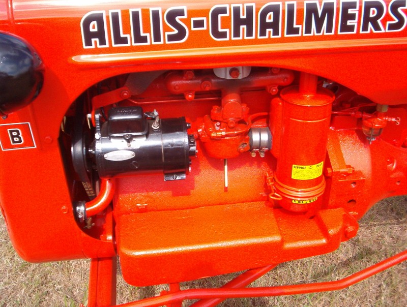

I have 2 B tractors I bought this year. I'm pretty sure they both have straight water in them. I still have a lot of work to do to them so I don't want to put antifreeze in them just to have to drain it back out but we're expecting a cold winter. Where do I drain the coolant to make sure the block is empty?

Drain at the bottom hose and behind the carb

Like he said.  you can see the copper pipe sticking out of the drain valve located behind the carb.  Most I have seen have been broken off.  also valve on bottom of pipe attached to radiator.

pull lower hose pipe all the way off and open block petcock.   I would probably get nervous and pour some antifreeze thru it also.  It aint that expensive
