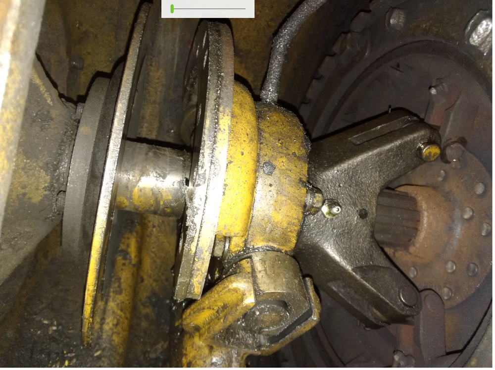

Post Options Post Options   Thanks (0) Thanks(0)   Quote WaltDevore Quote  Post ReplyReply Direct Link To This Post Posted: 24 May 2020 at 12:12am
Can anything be derived from this picture?

Post Options Post Options   Thanks (0) Thanks(0)   Quote WaltDevore Quote  Post ReplyReply Direct Link To This Post Posted: 24 May 2020 at 12:17am
I now notice grease zerks on the "fingers".  Should the splined shaft have grease there?

Post Options Post Options   Thanks (1) Thanks(1)   Quote gemdozer Quote  Post ReplyReply Direct Link To This Post Posted: 24 May 2020 at 5:54am
The  zerk is for lubrificat the sleeve on shaft and the greace hose is for the bearing in the carrier  and can see to much greace on brake cluch and hoke cluch shifting
